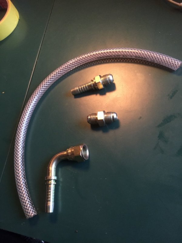

Sourced these fittings locally today together with some clear hose. Gonna put the hose in between the ip and return lines to check for air before I try the new fittings. They are not 100% correct, but the old school guys in the shop I was said they thought it would work as long as I applied some thread sealant. Fingers crossed..56186

And it´s a bummer! The fittings (that I tested towards the original hose barb that came with the walbro when I was in the shop) did of course not fit the walbro, so there was that. At least I got the clear hosing installed between the IP and the return line, and there is no signs of air on the diesel side, so at least that´s happy news - although there is still not much pressure going on.
