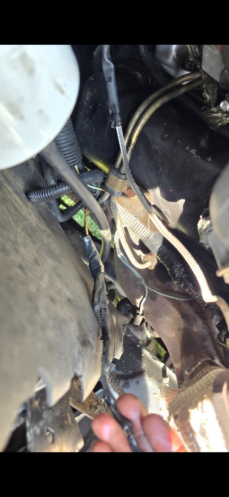

Swapping out the sensor is no biggie. It will leak some coolant when you do it, so just get the old one loosened up, then have the new one close so when you pull the old one out you can quickly install the new one.
Top off coolant and bleed out the air afterwards. Good to go.

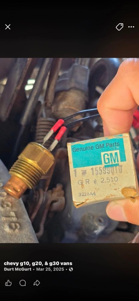

I would suggest getting a Delco sensor from an authorized dealer like Oriellys, napa, etc though instead of ebay. There are so many poor quality parts that fail much sooner out there, saving $5 isn’t worth it.
