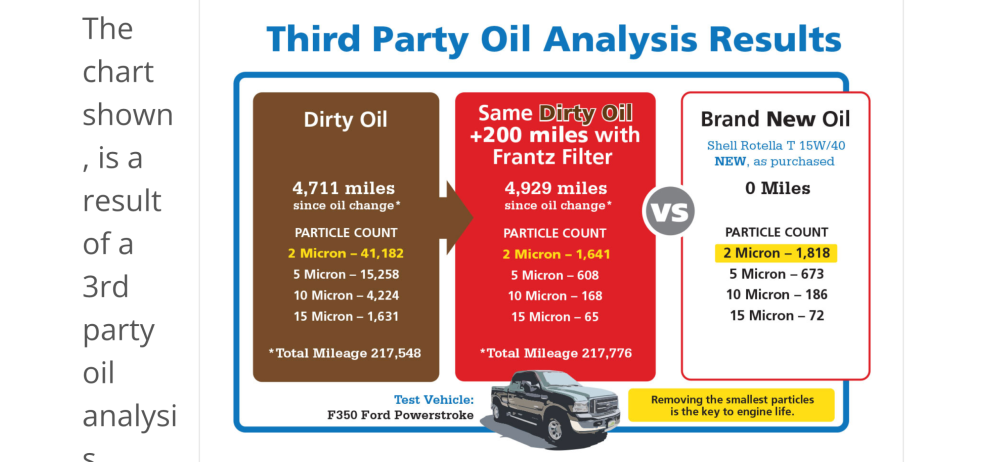

Wix (aka Napa gold) filter is still the best one made as a normal filter.
A Frantz bypass filter is my recommendation for most folks to take it to the next level.
My plan for my engine build that is about 10 years past due now is adding a drain & refill hose from the pan so I can hook up a 120v powered centrifuge for removing the soot while it’s parked. Unfortunately almost none of the centrifuges that are used in bypass mode clean any better than the frantz because it takes 100-110psi oil pressure to spin it up to speed for the 1/10 micron a centrifuge can clean to.
