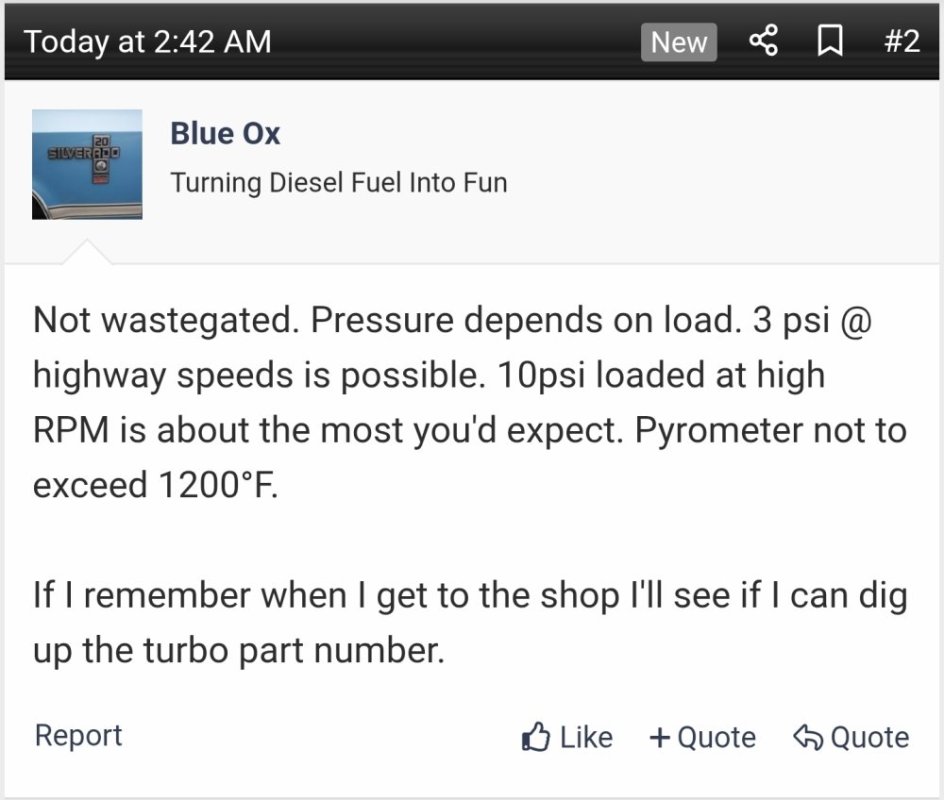

it definitely has no wastegate, and apparently when it's on OD, the boost PSI being that low is possible
Will say though, when i am not on OverDrive, i do see my boost jump towards 10 PSI, so there id that aswell, its only on OD where it stays low

Turbo on my truck runs at less than 5 PSI at highway speeds unless going upgrade.
If You are getting 10 PSI when not in OD then check the fuel mileage in OD and out of OD.
You might be better to run it in 3rd, or non OD just for the savings in fuel.

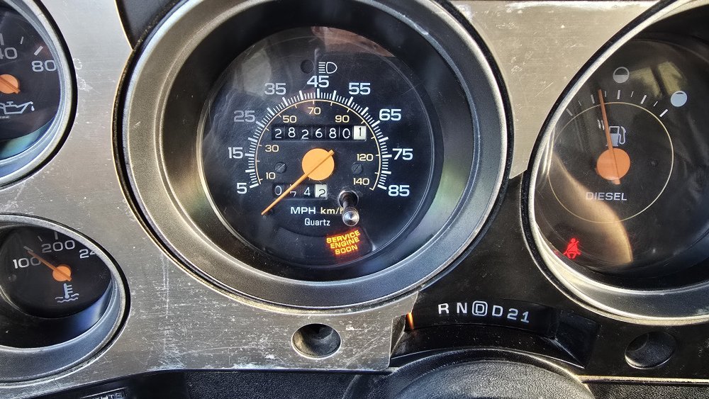

I replaced all the lights in my dash, now I have a "Service Engine Soon" light thats on, along with my brake lights flashing repeatedly now, what could the SES Light even be for? Lmao did not expect it to even have it, but i do have an OBD1 Port20250713_193517.jpg
Do the paperclip trick and count the flashes
Yup, IIRC, looking at the ALDL connector, it will be the A and the B terminals.
Turn on the ignition switch to run.
Should be one flash followed by two flashes, for a cycle of three times, code 12 to let You know there is communication to the ECM.
Then count flashes after that. They will repeat thrice then move on.
It will start back at the first problem code read when it has gone through all the codes.
