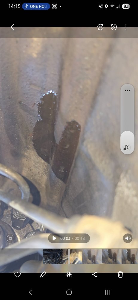

Its one of the line fittings to the pump, look at the bottom left side, you can see a small bubble form. That and the fittings are wetView attachment 94587
Going to get crow foot wrenches to tighten them now, I really hope the fittings are just loose, I mean, what the odds the lines failed? I'd hate for it to be the case, really hope its not, even then, would hate to try and find decent replacements

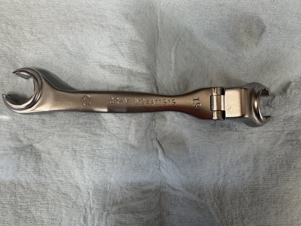

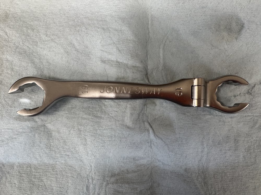

IDR who but someone in this forum suggested that one of these wrenches would get into those impossible to get to line nuts on the IP.
I added this to My arsenal of 6.5 tools.
Yesterday I got the chance to try it out.
I was able to get the flex end onto all of the lower line nuts and then using a larger square pry bar on the non flex end was able to get the line nuts snugged down one more ugga dugga so that meant the line nuts on My pump was all quite tight.
If the line nuts on Your pump are 19mm/3/4” then this would be the tool You could order.
IT STOPPED LEAKING, LETS GOOOOO,
RAN IT FOR A FEW MINUTES, EVEN PUT THROTTLE ON IT AND ITS BONE DRY

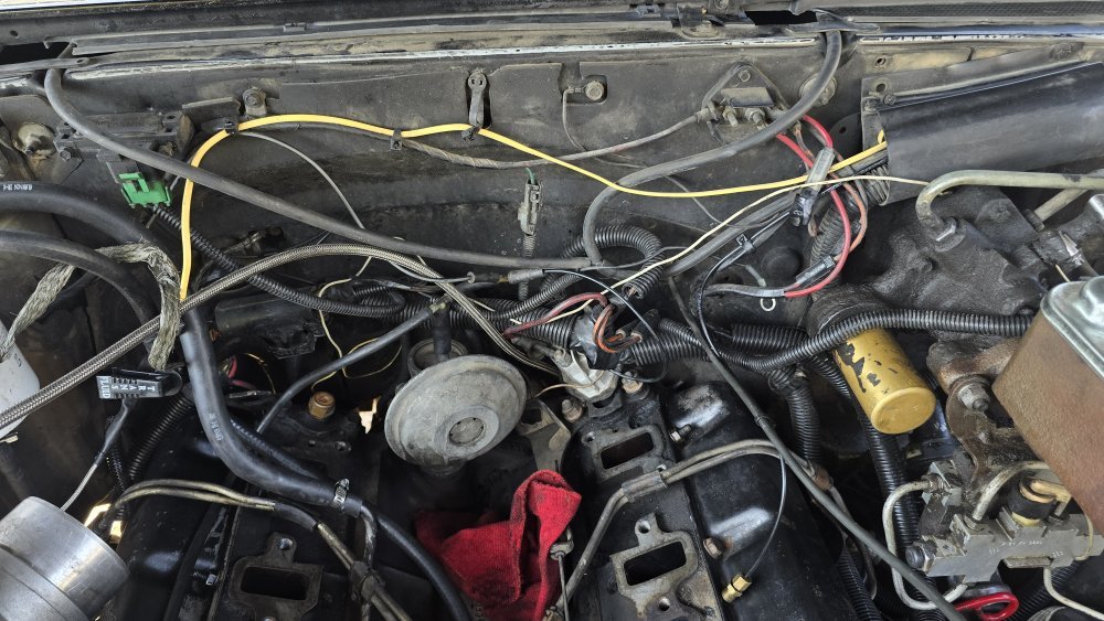

now im gonna fix the wiring before I put it back together, it looks so cluttered and messy here View attachment 94592
Stick a wrench on it and double check the tight of the thing.
Not worth the frustration of the steady drip drip drip.
Cheech and Chong found out.
Woohoo! Love it when a fix is just tightening something up.

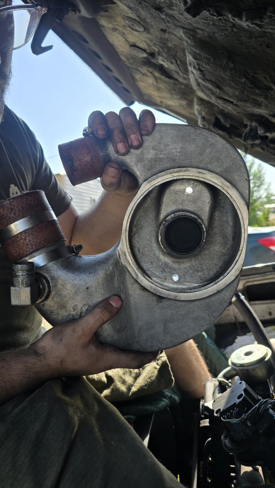

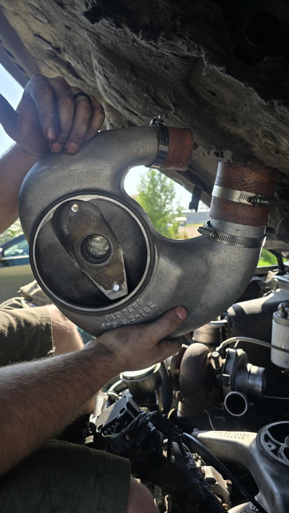

The reason the other intake manifold is better isn’t just to stop the flow of exhaust from going into the intake- but to stop the heat.
The exhaust goes against the intake everywhere and gets it stupid hot.
Think about a charge air cooler. It makes more power and better mpg, helps keep the engine from overheating, etc. the exact opposite of what is wanted is what the gases getting to the manifold to make it hot does.

Has anyone ever tidied up their engine bay btw? I'd like to make mine look more neat and presentable
Follow through with whats done in this thread and You will have perfection at its finest.
There is engine bay sessions too.
59 pages, Holy cow, will get on it
