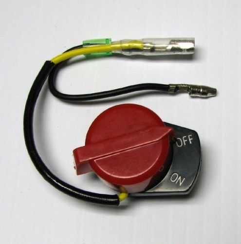

Do you have a timing light? If so, make a tdc pointer for the flywheel and rig up the timing light so you can find when it's firing. Also, does this engine use an ignition module? Many Honda's use the all in one coil, but the kill switch lead will tie into a small metal module normally near the kill switch. The ones I've seen are normally about 1 inch square and about 3/8" thick. It will have 1 lead going out and hook to the kill wire, and the module atatches to the block via a metal mounting tab. You can have spark all day, but if it has that ignition module, it controls the actual timing, and when it goes the timing goes all over the place. I've had this happen to my honda eu3000is generator. Everybody told me it needed an inverter, but it ended up being the $60 ignition module. I've also had a few fail on Kawasaki's with the same system. They all had spark, would run fine cold, but all showed there colors starting up hot. It's worth checking to see if it has one.
Hmm funny you should mention that. It does have a little square metal box like that. It ties into the wire going to the low oil sensor. It's not on any parts diagram I could find. It appears to have a diode in it as it will ohm one way but not the other. How does that affect the timing? Other engines I read about had what they called an igniter, same part?
Yes, many call it an ignitor. It varies the timing by rpm's as I see many of these engines have an idle down feature on them. You will still get spark for a few times without it, but it quickly dies off. Learned about them working on kawasaki mower engines. Had to hook up a timing light to finally chase down what was happening. I thought it was just a capacitor so it didn't burn up the cutoff switch, but learned it controls the actual spark. Then I had my honda where it would run great for 10 minutes, then start popping, and shut off. All the shops said I was wasting my time replacing it, but that was about 10 years ago, and it's still going. They don't fail often, but when they do, they can make you pull your hair out.
