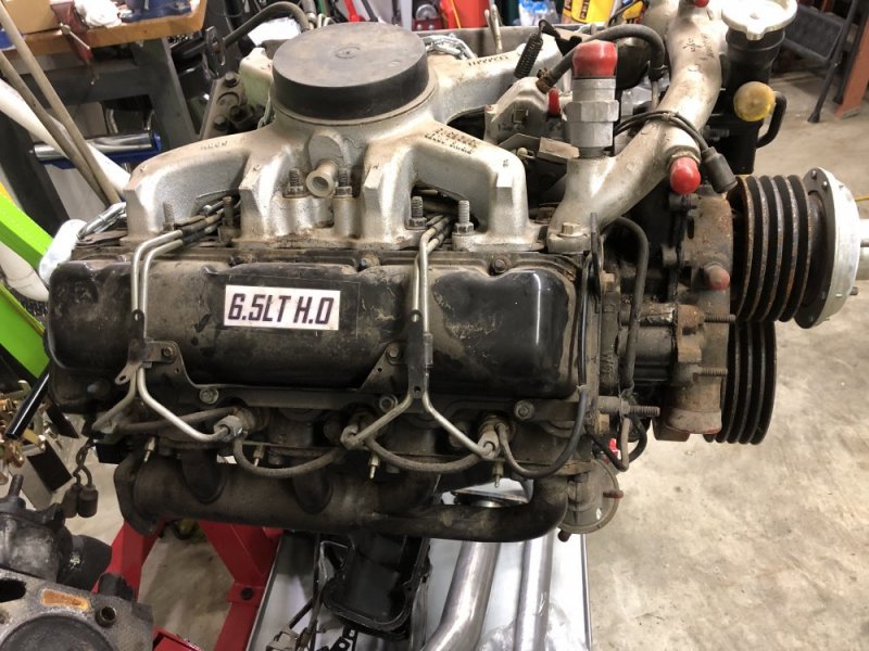

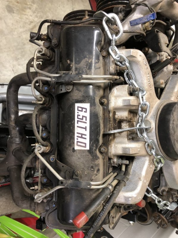

Hello again. I just recently purchased a HMMWV 6.5LT H.O. motor that was still in the crate. I do not know a lot about this motor except the person that I purchased it from said he thought it was new crate motor and not a reman? That was what he was told when he purchased it. He has had it 2yrs and was going to but it in a J10 Jeep that he recently sold. I pick it up for $1000.00 So I thought it was a good deal. I am going to put it in a 86 M1009 CUCV. And add a Holset HX35w with a Banks passenger side exhuast manifold. Does anyone the HP-Torgue numbers for this motor?

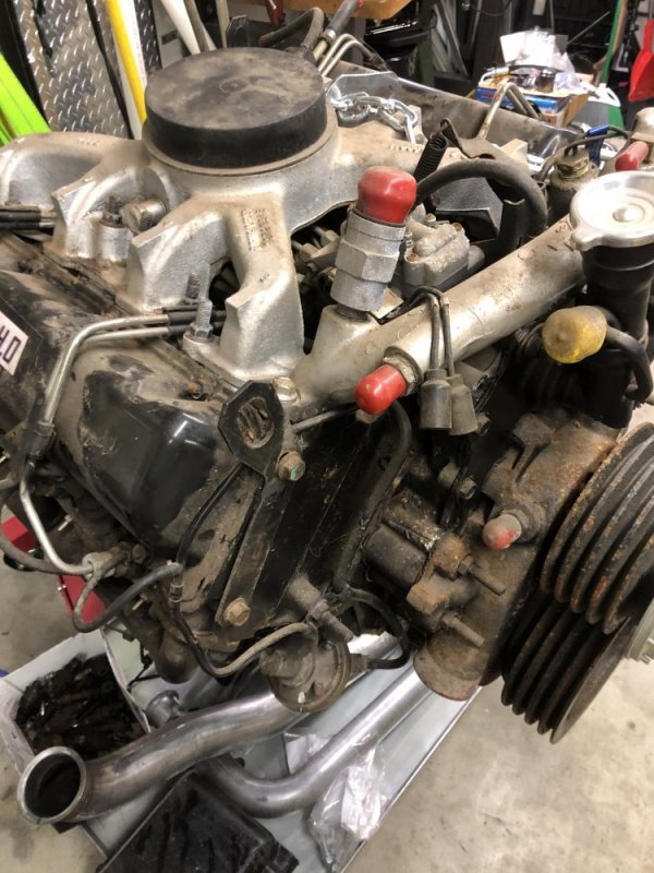

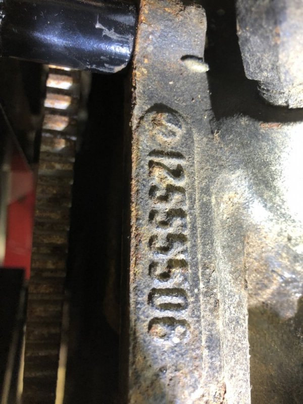

That is not a factory sticker on the valve cover from either gm, gep, or military.

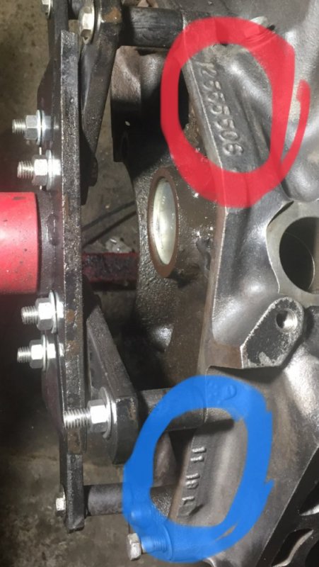

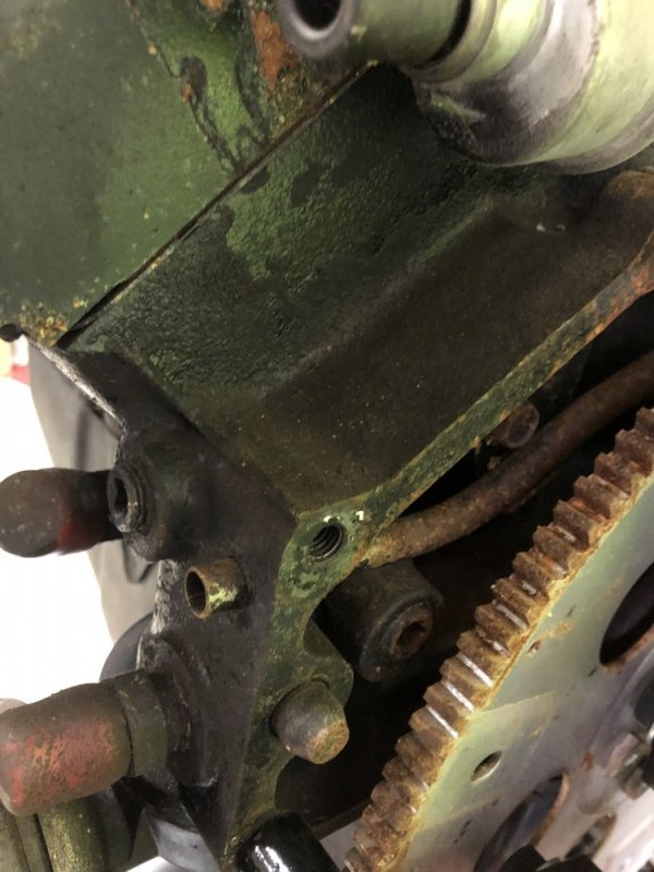

That is a n/a engine of some kind. Take and post a picture of the Julian date code on theright rear of the block just behind the head. Also take a pic of the left side rear top bell housing. I’ll post a pic of the area in a couple minutes.
From the right front stamp, I can tell you it is a gm block of some kind, not a GEP from zooming in on your pic:
55933
The next picture is my GEP. The red circle is the casting group. The blue circle is the julian date code. These are the numbers needed.55934

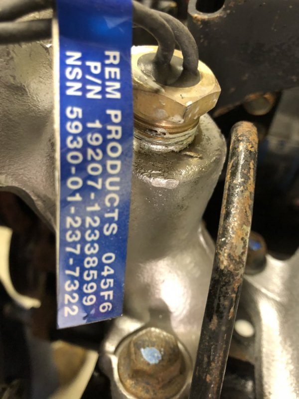

Also on the injection pump, there is a metal label on it about 2” X 3” that has a bunch of stamped numbers. Wipe it clean enough to read those numbers in the pic and post it.

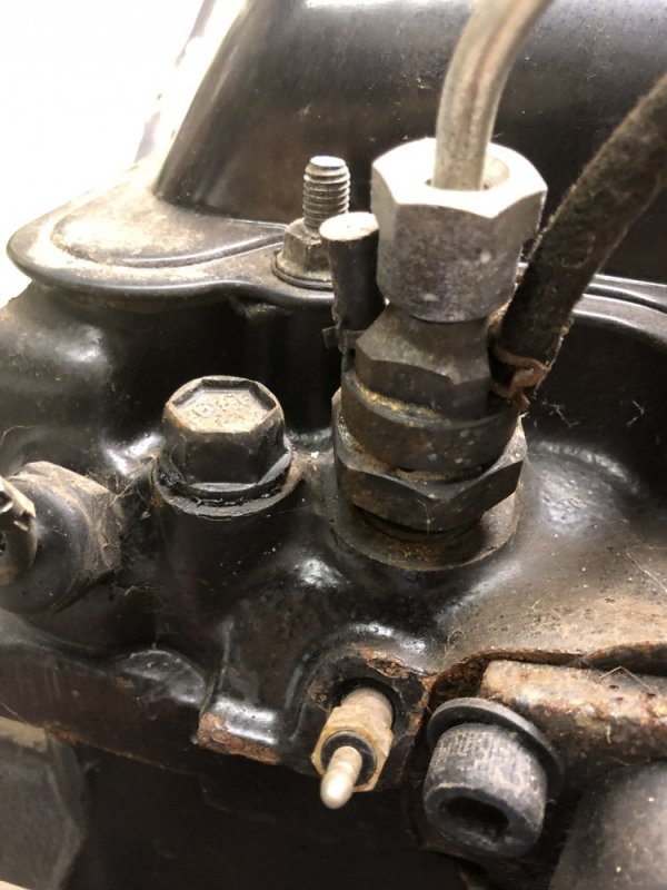

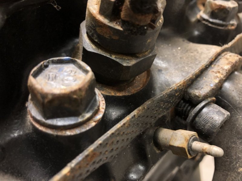

Then the injectors should have a colored ring on it. What color are they?

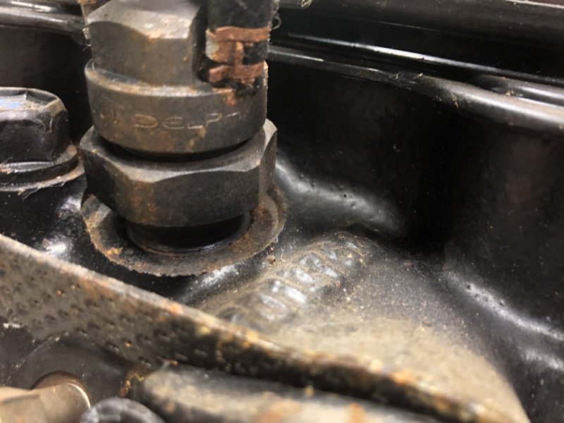

Thank you for fast reply! The injectors really do not have any color on them? They are Delphi and there looks to be a sealant on the middle of the injector and I’m guessing it was white from the factory and now is turning yellow?? The injector pump reads
M4 DB2 831-5149
11d47319 12550433

I personally removed it from the military crate. And yes one side and the top of the crate were already removed. Any opening that the motor had hoses-exhaust-intake were covered and caped from the factory. It had been sitting in an old garage that his late grandfather owned and no one used but to store things in. "Yes its dirty" but its cleaner than the garage it came out of!! I already have a set of heads that came off a 97 6.5 that have been rebuild and have diamond precups installed. I had planned on installing those heads-holset turbo-banks passenger side turbo exhaust manifold on the 6.2 that was in the CUCV. Now that I have this motor on hand the game plan is probably going to change some......
Pump info:
DB2831-5149 12550433 1994-96 HMMWV (Military) - N/A, 1.2 cSt (170 hp) * — —
Definitely not high output. Your injectors will be the lower ones as well.
The F 09 9 breaks down as June 09, 1999. That is the last casting change that was ever done by GM.
A= Jan
B=Feb
Next two digits are day of the month.
Last digit is the year 9 is 1999
8 would be 1998...
So you have a 50% chance there is diamond precups in there.
Tear it all down and see what you have- dollar to a donut says that came out of a hmmwv when the hmmwv got an optimizer installed during overhaul.
Sorry to be bearer of bad news on the homemade sticker.
The engine crate makes a great test stand with a little modification.

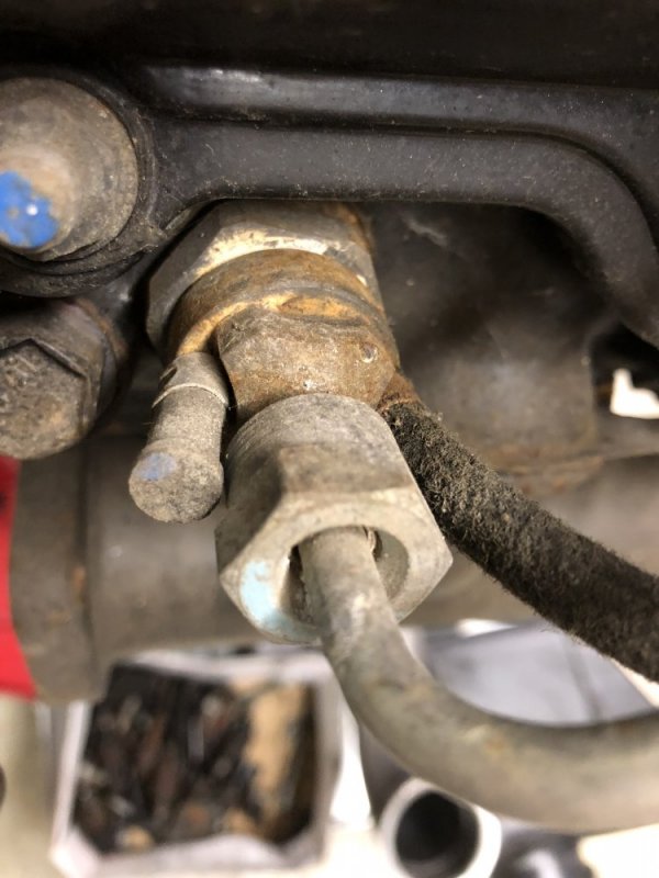

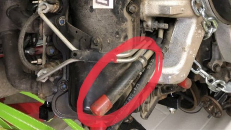

This is not a rebuilt engine. The caps everywhere are for storage on removed ran engines. See the cut fuel line with the cap I circled? This hose does not used as crimped on rebuilds. For one example. They are just required to cap ends that can bleed oils and fuels. There are several other things that could be pointed out, but moot. Tear it apart and see how she looks.
Get a mic incylinders 7& 8 asap. Then look at main webs.55950
Also, incase you aren’t aware- that intake manifold on there that resembles the lower on a truck- is different slightly and is only used on n/a hmmwv/hummers. The turbo ones use a very different intake manifold.
