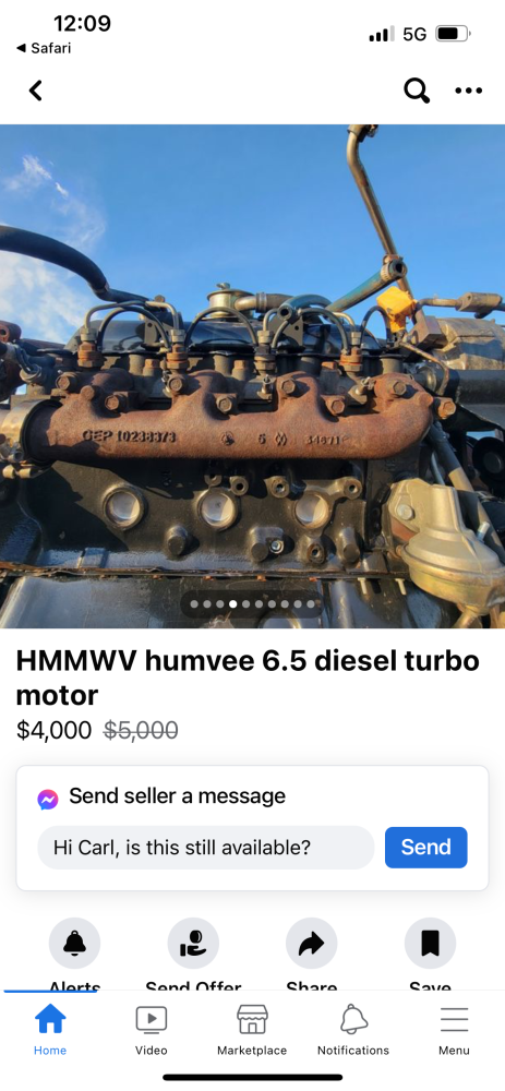

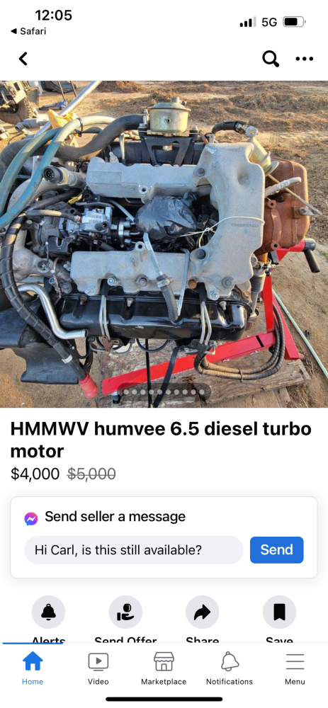

Looks like an Optimizer. Claims only 1200 miles. Nearby me in Anaheim Hills.

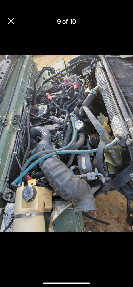

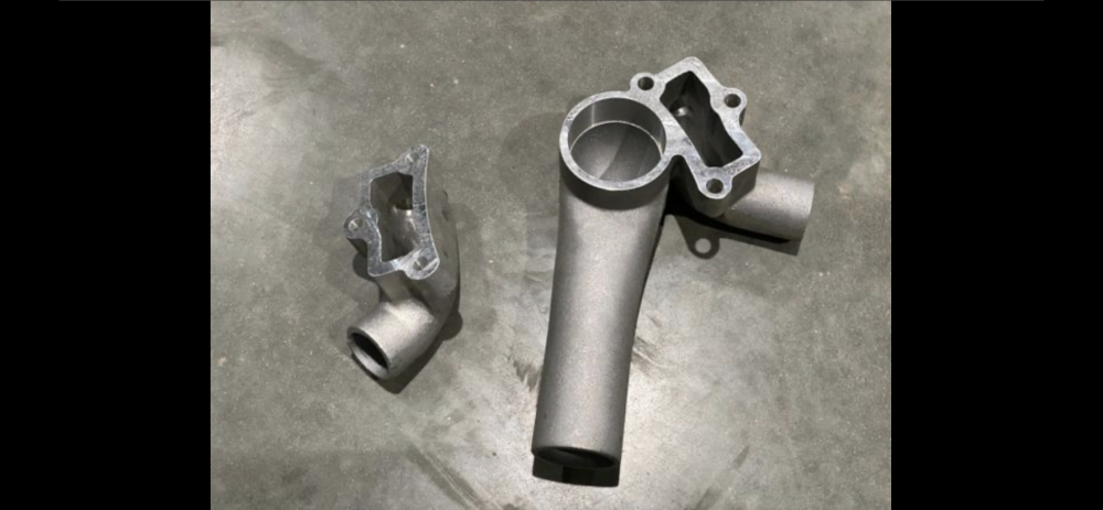

Adapting in the truck intake would be a pain from bolt angle. I did the reverse on mine using that intake and turbo onto mine that basically has a truck intake minus the ffm mounts.
That db2 could be altered into 12v for about $200.

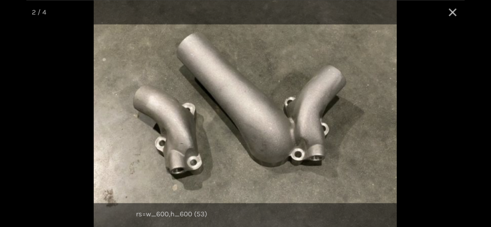

You could remove the turbo and block of the oil ports. Sell it and the exhaust manifolds with up pipes. Then buy the adapter piece for coming from the inner cooler from ModMafia and make your own hose adapter.

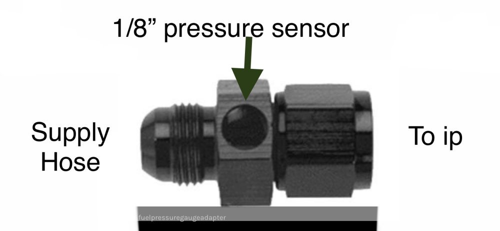

Here is the fuel T fitting from ModMafia.com
Fuel Pressure Gauge Adapter
A fuel pressure gauge is essential to monitoring the health of your fuel delivery system. Mod Mafia makes it easy to add this important gauge to your Hummer / H1…modmafia.com
The fitting goes in between your incoming hose and the ip.
You screw the fuel pressure sending unit into the 1/8” port on the side. Only thing you have to add is the fuel pressure sending unit. With it screwed in nothing can leak, you could drive truck and do the gauge part later if needed.
I posted pics of one installed on a hummer intake- that is really tight but fits. The truck intake has a little more room there.
Do you have a link to the Summit part?Dang, a 50% mark up vs summit.![]()
Not right off, I just bought a few myself for tranny temp and other gauge places so I know they are much less and readily available.Do you have a link to the Summit part?
