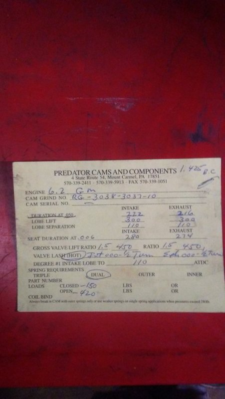

This is the cam card from my first cam. It had way more power,and super quick spool up. But had egr from overlap,so it started hard ,and ran off of its own exhaust . Basically it ran horrible untill the turbo spooled.

So I would like to try it again, with like .600 lift , and stock duration. A long time ago I had checked things and it looked like it would work , with different springs obviously. Feel free to post up any cam specs you might have,since one of our cam threads got deleted .

I like how the p400 opens exhaust later. I think this is one of Heath's tricks . I bet the exhaust opening point could be 10 degrees later,for more torque. This would dramaticaly change turbo exhaust turbine requirments.
