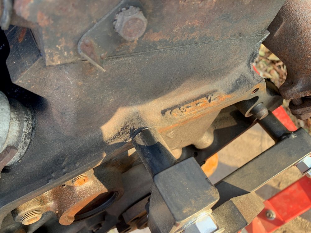

I was planning on stopping by the car wash later this evening and spray down all the areas where the block castings and date codes are on the engine so I could get the numbers off of it. I had gotten the block cast numbers off from it in the past finding that it's a 929 block, but I would like to know if this is the engine in it from factory since my rig now has 290k now.
what areas should I look and how would I read such numbers to see the date codes and what not for my engine?
Yeah, I think that's where I remember seeing the #'s on this 6.2 block. I will post them up if I can get a clear pic and maybe someone can tell me how to read them and know if this is the factory engine.

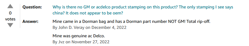

I don't like shopping on Amazon but here's a genuine AC delco balancer for $90. Says it ships in 3-4 weeks but way cheaper than $350...
I had looked at that one, but some of the questions mentioned a dorman in the box. I suppose with their return policy I could try and order one. if it looks suspicious I should be able to return it. Here is one of the questions that was on that listing.

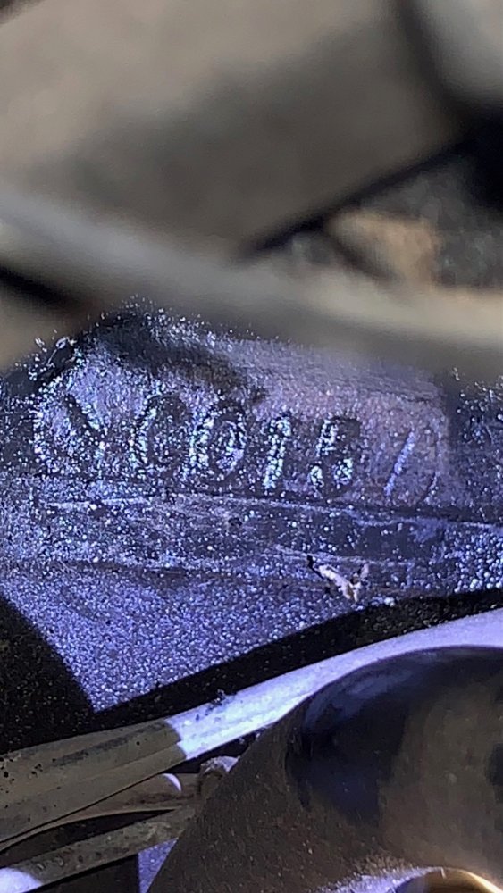

I finally got around to trying to take a pic of the date code on my engine. it's hard to get in there with a flashlight and my phone, but here is a pic.
it looks to be ether "0015" I can't really tell if the first digit is a letter like "C" or "G", but I think this block is original to my truck. let me know what you all think. I do know that the block cast is a 929.

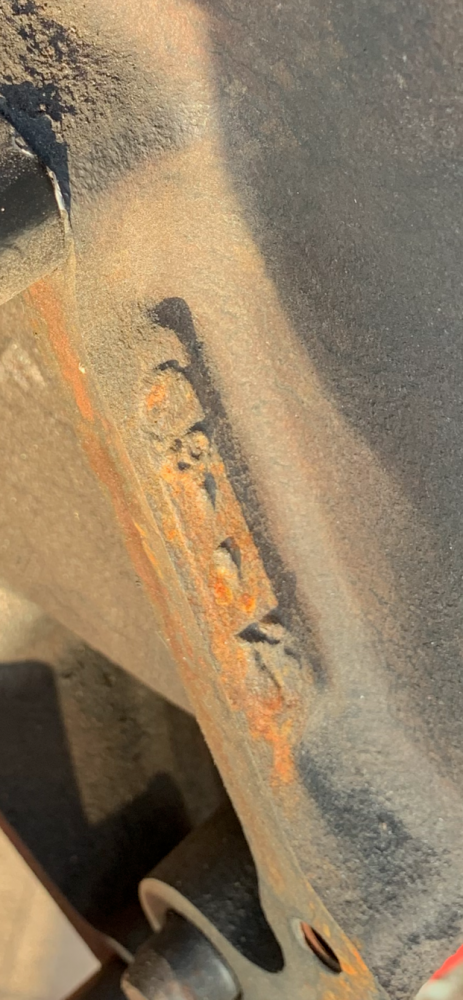

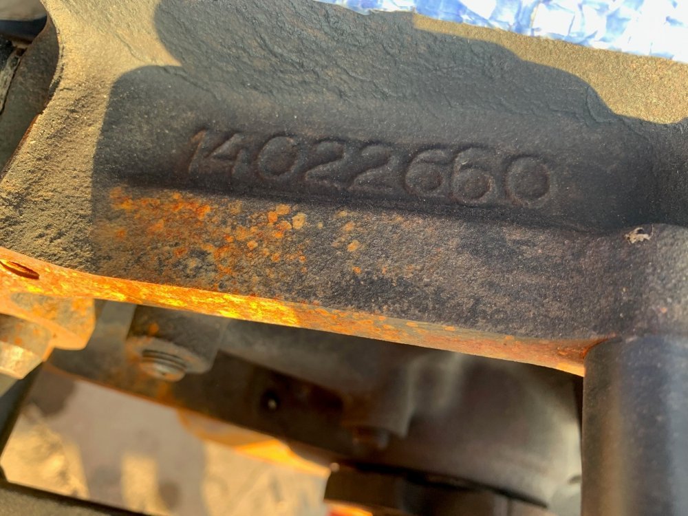

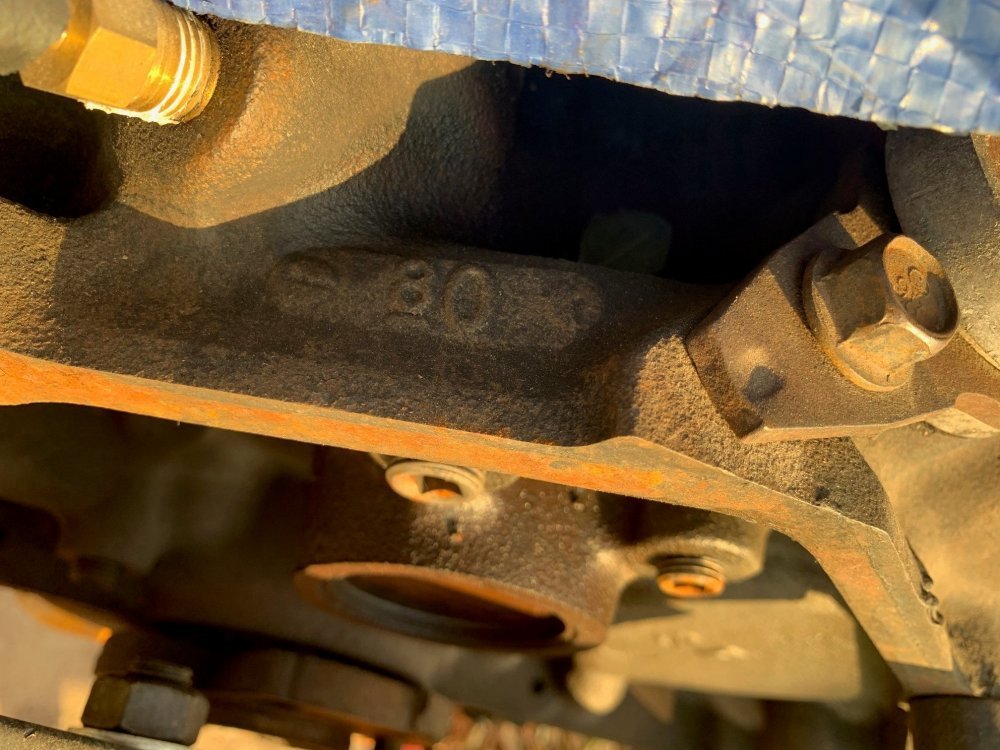

Here are the cast numbers on the 6.2 I have on the stand. I can't figure out the date code since it only has two numbers with dashes. "9--2" it also has "80" stamped up near there the oil pump drive cover is toward the drivers side. Here are those pics if someone can figure out the age of this block. one thing to note. this block has a two piece rear main seal.
6.2 block cast.jpg6.2 date code.jpg6.2 date code close up.png6.2 unknown cast.jpg

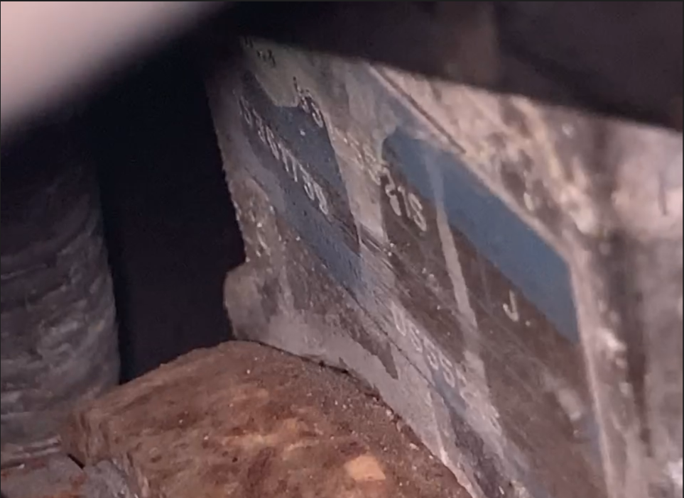

I do recall finding the tag on the IP and I think I had taken a pic of it. I will have to dig though my phone to see if I still have it, but something tells me that the date stamped on the tag (blue or green iirc) was in the early 2000's year.

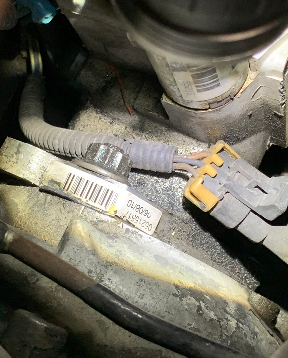

I did locate the pic I took of the tag on my IP. you can't see a date on there, only the serial number and the part number However there is a sticker barcode on the base of the pump right where the bolts are holding it to the timing cover. I shot a pic of it also. it shows a date of June 8th 2010. so I would assume with a 13 year old pump it has ether exceeded or is just about reached 150,000 miles in it's life. whats the average life span of the DS4 IP?
