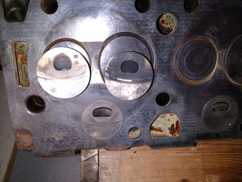

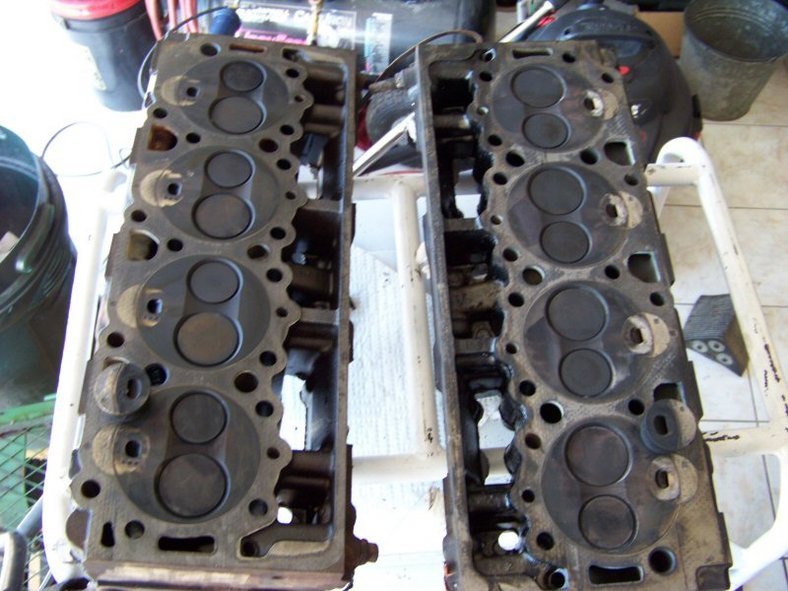

Precup comparison:
Precups… 3 Bars came out of a NA 6.2 military CUCV engine, Square was in Patch when I bought it assumed 6.5 NA precup. And Diamonds.
56419
On the left is a head with Military precups on a 1986 6.2, 3 bars. The cups sitting on the head are 1995 turbo precups, round dot. The head on the left is 1995 NA 6.5 precups, square mark. This just scratches the surface of all the precups GM made and the 'opinionated best for turbo' latest Diamond marked ones are shown above.
56420
