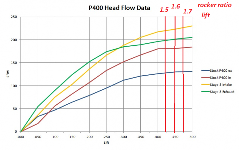

Finished up the work on my P400 heads now all that's left is to finish the coating on the combustion chambers...
This data is a direct apples to apples test, P400 before and P400 after, the heads have both bigger valves, valve unshrouding, coated runners, 2 angle valve job, ( stage 3 )
These heads made a visit to the flow bench 4 different times during the process and the flow was measured every .050" lift...

I'm a little surprised no one has mentioned the exhaust side out flows the intake for most of the lift.. and I'm building for 2500-3000 rpm and a weight over 20k all the time, so we will see.
I completely over looked that!!
I know there is math out there that can help match a turbo to the engine based on CFM numbers. I'm at work so I don't have time too look but with the heads flowing over 200cfm on both ends x 8 cylinders would mean the engine can flow 1600cfm? (Of course that would require all the valves to be open at the same time, and only 4 valves open per one crank revolution so im sure that is not accurate).. and a HE351VE flows 800-900cfm.
Just My personal thoughts that, once the heat of combustion is added to the exhaust flow, that flow will increase quite a bit more. But, I aint real smart on such matters and there might be a lot more play into the figures so I might be wrong on My ass-umptions. . 🤷‍♂️😹😹😹

And the VGT I think will compensate for the lower rpm area, and I am more concerned about on road at speed not stop and starts...
@Twisted Steel Performance, sounds like you're building for a heavy hauler, not a stoplight to stoplight racer. Just read this thread and looked at your flow charts, impressive gains on the exhaust side (intake not so shabby, either) that should show up in ability to really spool up that turbo at mid to upper rpms and being VGT shouldn't have much problems spooling up off-idle, either. Yeah, be interesting to see engine stand and rear wheel dyno numbers for the finished build.
