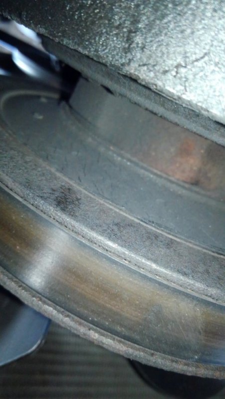

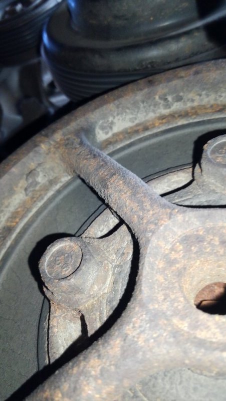

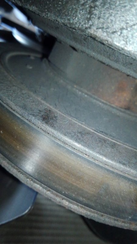

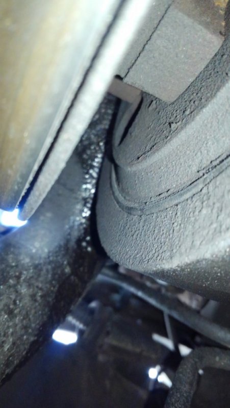

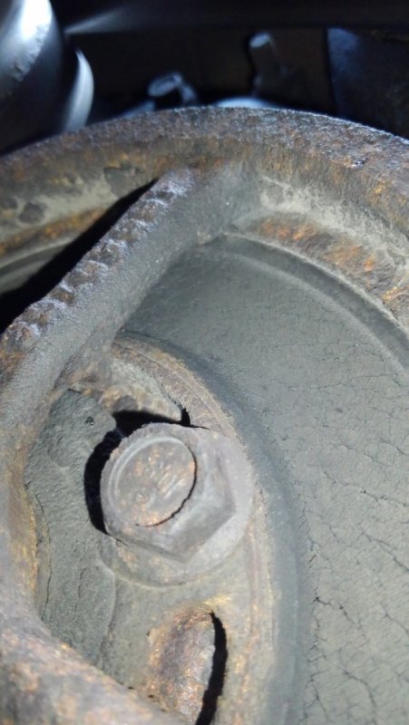

I got a couple pics of the harmonic balancer.... Tell me what y'all think of the condition... Get it changed now or can it wait??

That’s the belt dampener and yeah it’s time to change it. Looks like it don’t have long before the rubber lets go completely. Hard to tell how long though.
The balancer is right behind it
For harmonic balancer. Fluidampr. Once and done forever. I don't like doing it enough to do it twice
