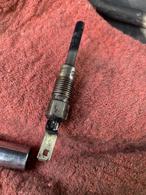

unfortunately I don't have easy access to a diesel compression tester unless someone knows of a fitting of the same thread as the glows I could rig up on a gauge to use type thing.
