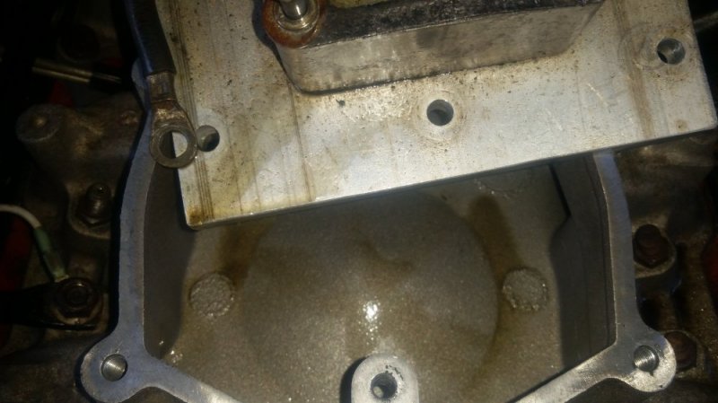

Once my heart rate slowed to a normal pace I noticed a moderately large puddle of oil under truck right below the air filter. First thing I checked was if the engine was locked up, nope still turns by hand. Decided to do a leak down test. Started with the drivers side since they're easy to get to. Cylinders 1 and 3 when tested showed a 40% leak rate and push that air into the oil pan. Made a nice gargling noise unless I took the oil fill cap off. Cylinders 5 and 7 didn't produce the noise but were around the same leak rate. This was done after turning the engine to make sure the valves were closed. I haven't even bothered with the other side yet. I'm thinking it ate the rings. I'm still not sure what caused it yet or how great the damage is.

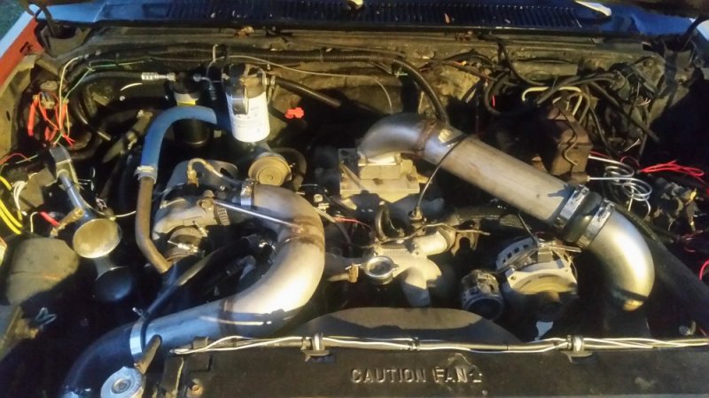

Intercooler. Sweet.

Sounds like a classic oil fed run away to me. I keep thinking of putting a block off safety valve on mine- with your inner cooler plumbing there, it could go inline easy just to make sure it never gets you again.

Quick and dirty: how much oil is in the CDR and CDR oil soakable intake pipe in front of the turbo? That's awful clean oil for a 6.x - you sure it's engine oil?

CDR valve had some oil residue but that's it. The tube from it to the intake preturbo had enough oil in it to actually move around. So something cause the oil to blow out the cdr.
