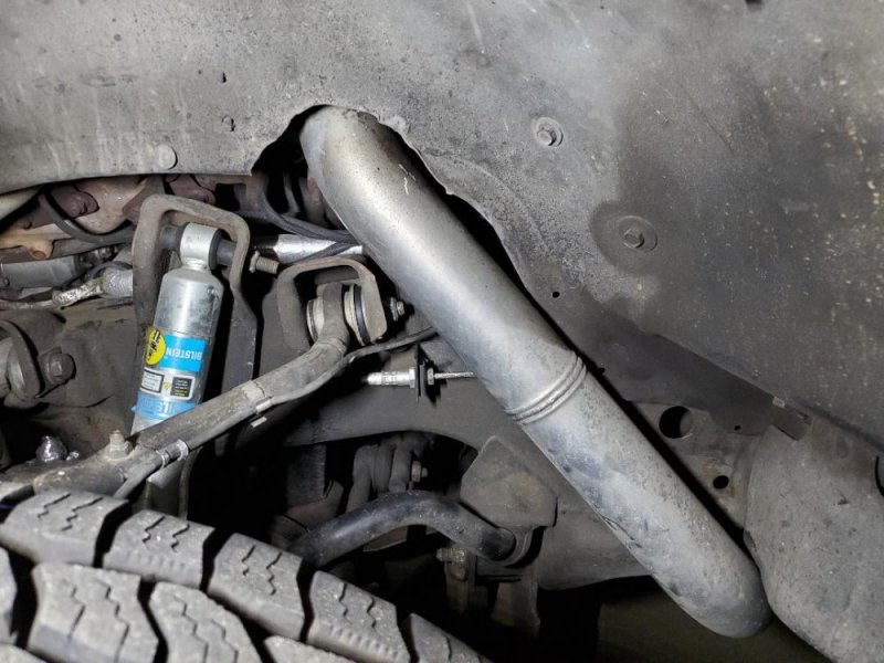

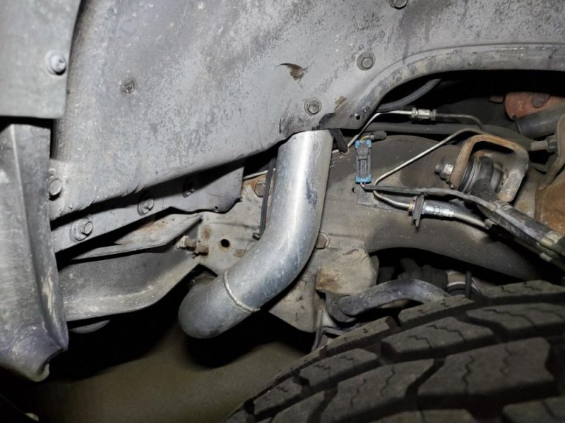

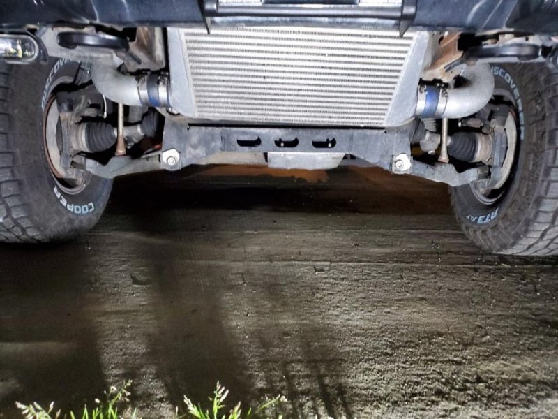

Not really the case for me. My ATT with CAC and ATT makes more power from idle all the way through the power band than the GM8 ever did. My CAC is mounted where the plastic skid plate thing was mounted stock so not causing any heat issues with radiator. Been there for 15 years and never had a problem puncturing it. I run 3" aluminum tubing the whole way. And I averaged 1-2 MPG better than I do without it. On a 100 degree day going down the freeway my IAT's are 105-110. Ford felt that the OBS Powerstrokes didn't need a CAC also. After I did mine on my 6.5 my buddy did one on his 96 Powerstroke. A little better mileage and way better sustained towing power is what he noticed also with his all stock engine,tuning, and fuel delivery. They only do about 15-20 psi of boost also. Pulling the sierras I get about 18lbs of boost with my ATT. If I was experiencing severe lag, I would remove it maybe and see what my IAT's do when towing, but lag has never been a problem for me.
That looks to be a nice clean setup. I had the thoughts of installing a CAC under My 2000 K3500, I just imagined it would hang a lot lower than that.
