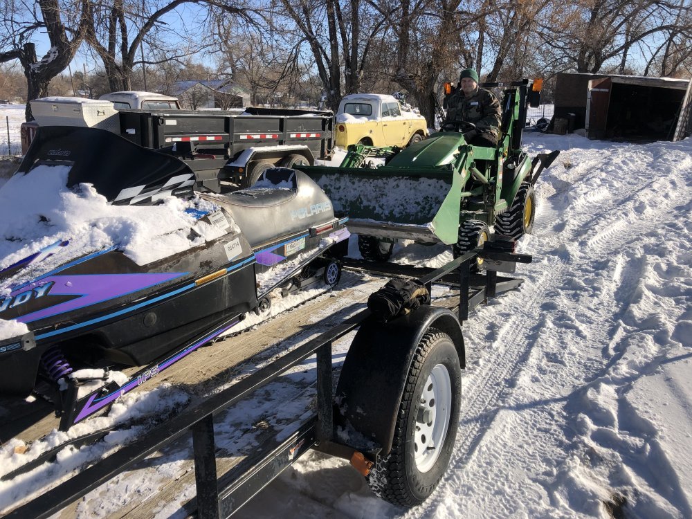

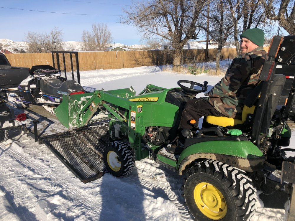

The son, going to shove the snowmobile onto the trailer, using his JD tractor with the loader bucket.
Just getting started and the JD starts sputtering and cutting out. Kelly had some Stanadyne performance formula additive. Maybe a pint left in the jug.
Me not knowing hos big a tank tje JD has, told him just dump that in there, he gives it a couple of dribbles and says this whole jug treats 500 gallons, or some such. He lets the tractor idle for about twenty minutes and it aint changing. Told Him we need to go get some no. 1. And so we did. After about an hour, with the big kerosene blower heater pointed at the fuel filter and engine on a fast idle, it started running a little better so we proceeded to load the snowmobile. By the time we got it shoved onto the trailer the tractor was running quite well.
In all the years of working as a mechanic for the DOT, that is the first experience I have had with gelled fuel.
