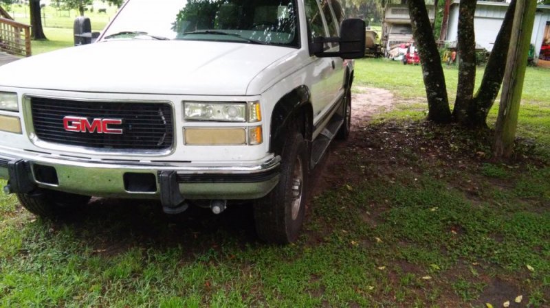

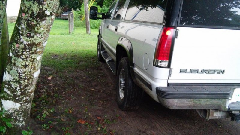

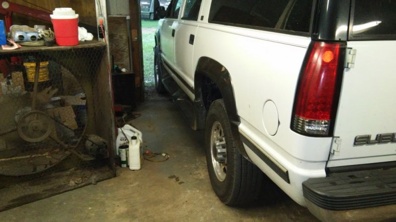

I picked up a set of 2" wheel spacers a couple of weeks ago, so I decided to install them and put in a set of 1 3/16" DRW wheel cylinders while I was at it. WHAT A DIFFERENCE! I was a bit upset that my wheel cylinders that were less than 2 years old were already leaking, but for about $21 I got a set of AC DELCO 1 3/16" wheel cylinders off of AMAZON to go back in it. The larger wheel cylinders now give me the kind of brake bias it should have had from the factory. I can actually feel the rear brakes under light braking, and when I get on them there is NO MORE wandering. It stops straight as can be now. I had already put in the updated proportioning valve, and DURASTOP shoes like the TSB said, but I still had some wandering under hard braking. Not now, and it takes no where near the amount of pedal pressure to get it to come to a stop. Still debating on going to DRW front calipers, pads, and rotors when it is due for brakes again, but I will defiantely at least be going with the DRW front rotors as they are MUCH beefier than the SRW/2500 rotors. And the wife was complaining non stop about me putting the 2" rear wheel spacers on it until she seen it with them on. It looks SO MUCH better now, and I think it drives a little better at highway speeds. It doesn't seem to want to wander and be pulled so much in the grooves in the road, and didn't take no where near as much wheel correction on varying road surfaces after installing them. All and all I should have done the wheel cylinders earlier, and the spacers just make it look correct instead of lame with the recessed wheels in back.
Before

With those spacers in the rear, will probably notice the RV sits a little straighter too. And semi's will now surprise you when their cab gets to your front window as the 'bow wave effect' should nearly disappear :cool:
My propride hitch took care of the bow wave effect. I didn't expect the spacers to help it run straighter empty though, but they sure did. Debating on going to the DRW front brakes now as from what I can find the larger calipers and thicker rotors should swap right in as SRW and DRW trucks all use the same hub bearings and spindle arms.
