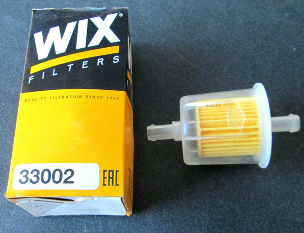

I cut the metal line in the frame rail (larger one from the fuel tank) before it gets to the LP. the inline fuel filter came with to pieces of hose and clamps which I used to install the filter. Wix part number 33002 which is a 5/16" inline filter. iirc the steel line is 5/16" measure yours first. if it's 3/8" then you will want the 33003 filter.
it's not made to catch water, only larger particles of dirt and junk that would destroy a LP. the main filter in your FFM is to keep the finer crap out of the IP.
if you go this route, get two filters and keep one in the glove box for spare. when it clogs it will give no warning and cause a no power issue starving the IP of fuel.
