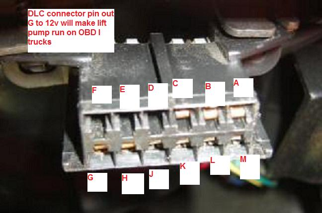

on a 95 you can trigger the fuel pump manually by using the PCM connector under the dash. just run a 12v positive wire from a fuse or from the cigar lighter to pin G in the connector. that will turn the lift pump on. leaving the bleeder open on the filter cap with push all the air out. some folks will attach some sort of tubing to the bleeder and run it into a catch can just to avoid making a mess on the engine.

The lift pump can also be cycled by unplugging the lift pump relay and jumping a wire from the + terminal of the relay plug to the, IIRC, grey wire.

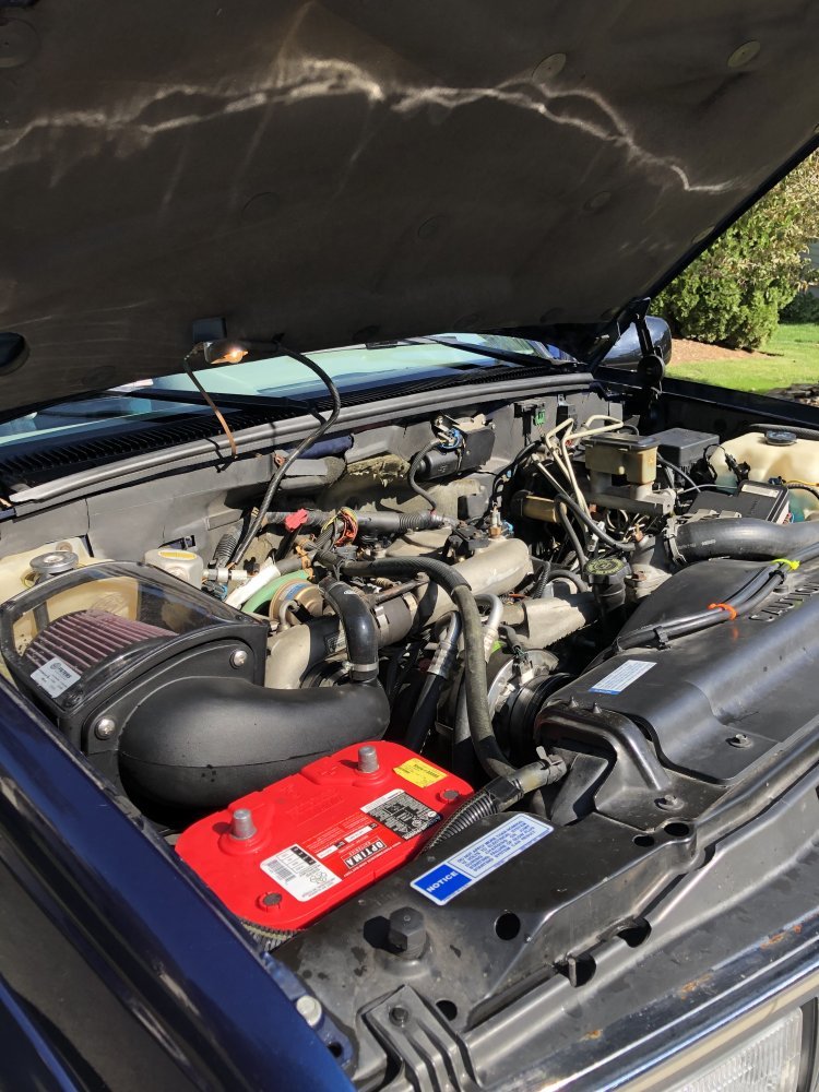

Just out for my morning walk....
Lions Burbon is running like a top, still more work to do. Maybe the Raiders will let me come polish those trophies after the season!
