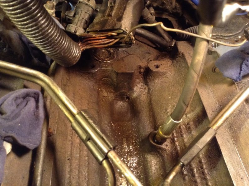

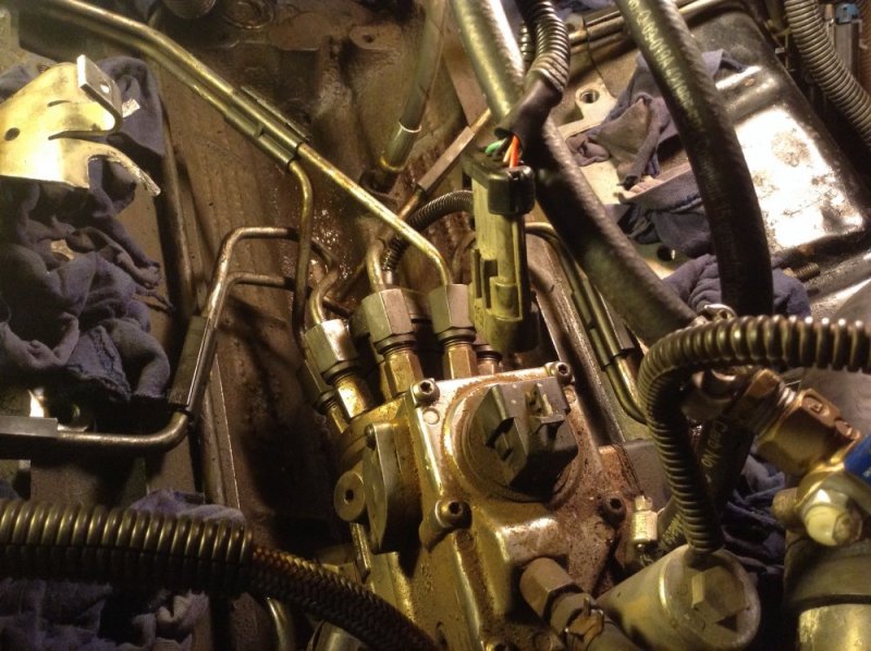

8) remove IP fuel hard lines:
-passenger side of engine are cylinders 2,4,6,8.
-driver side of engine are cylinders 1,3,5,7.
-follow and lable the hard lines to the connectors on the IP.
-start with removing 1-3, then 2-6, then 4-8, then 5-7.
-install in the reverse order.
-install torque 24ft/lbs. (both ends).

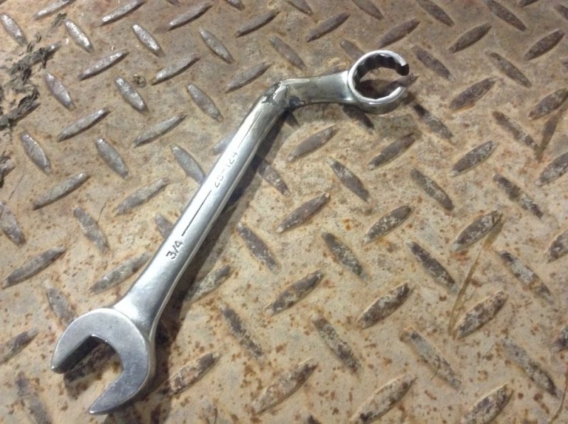

Tools: I modified a 3/4" wrench by bending it and cutting a slot in the box end (see picture).
9) clean area around where the IP is inserted into the drive gear box.
-make indicator marks on the IP and where it inserts into its housing.
-want to put the new IP back into the same place as the old one. This keeps the pumps timing.
10) To remove pump:
-remove the front 3 bolts through the oil intake hole.
-find the first bolt by rotating the crank clockwise by the crank bolt (15/16").
-stuff the bottom of the hole with paper towel.
-loosen bolt, then hand remove until bolt is free.
-before removing, trap the bolt against the socket using your finger.
-repeat process for each bolt (remove paper towel for each engine rotation and then restuff).
To replace front bolts:
-same process, but use grease in the socket to hold the bolt in the socket (install torque 20 ft/lbs).
Next:
-remove the back three nuts...bottom two first, then the top. Then, slide the IP back and out (install torque 30 ft/lbs).
-note the pin on the IP front, orient the new pump pin face the same as the old pump. Since the pump turns counterclockwise while on the engine...twist the new pump face counterclockwise to orient the pin.
-transfer indicator marks on the old pump to the new pump as close as possible.
-insert new pump; using the top nut first, orient marks and tighten all three nuts (30ft/lbs).

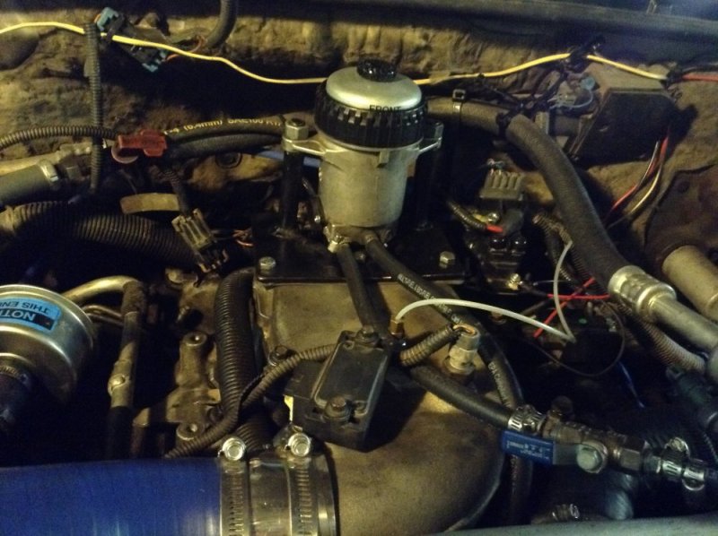

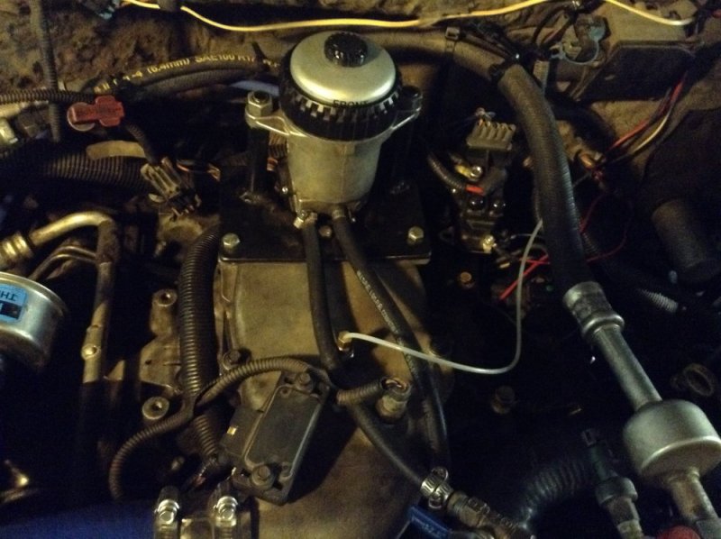

I modified my FFM, moved my glow plug apparatus, OPS, and wire harness up and out of the "valley" (see picture).
