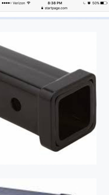

Front receiver, Finally. [emoji1]
Smart building that rack with the drawbar/ reciever tube so you can tow with it or carry more accessories when in the front. Guessing your going throw bikes on the front?
I would probably have it to flag the front of it so I dont forget it's there and smack something when I park if it is empty- haha.
The front receiver also works mighty slick for driving boats down a ramp and for parking trailers too.
Yeah, Put front hitches on most of my trucks for that reason. I can back a trailer up alright, but you dont want to wait your turn for me if it is anything other than basic.
After a friend saw mine, he added one to the front of his Yota and now doesn't scrape up his really steep driveway with his boat of razor trailer anymore since the approach angle is good on his truck.
We had the bikes on the front for about and hr, but the truck was running to hot with them there. For some reason the weather went nuts this week and its been 90deg plus this week. [emoji33][emoji27] So we ended up strapping them to the top of my moms pop up. I also need to pull and clean the radiator as well. If not just replace it. Its old and got a lot of dented fins. And its just plain nasty. The rack is great. My buddies brother in law built it for him but it didn't work on his 5th wheel the way he wanted so he said I could have it. [emoji1]
That rack looks sharp! Looks like you will get a lot of use out of it.
Normally we put it in the back and use it as a "deck". But with me pulling the pop up as well the tounge is so low with the rack in the back. So that's why the basket is in the front. I left the tail gate on this time.

off topic, but you can route your heater cord down so it comes out and rests in the bumper hole on the driver side, so it's not flopping around up by your hood and grille. There should be plenty of cord to do so.
Nice build on your hitch - you lost your tow hooks, though - bummer.
I actually like having it up there. [emoji3]
And luckily the bolts were long enough for the hooks. [emoji1][emoji1][emoji1]
