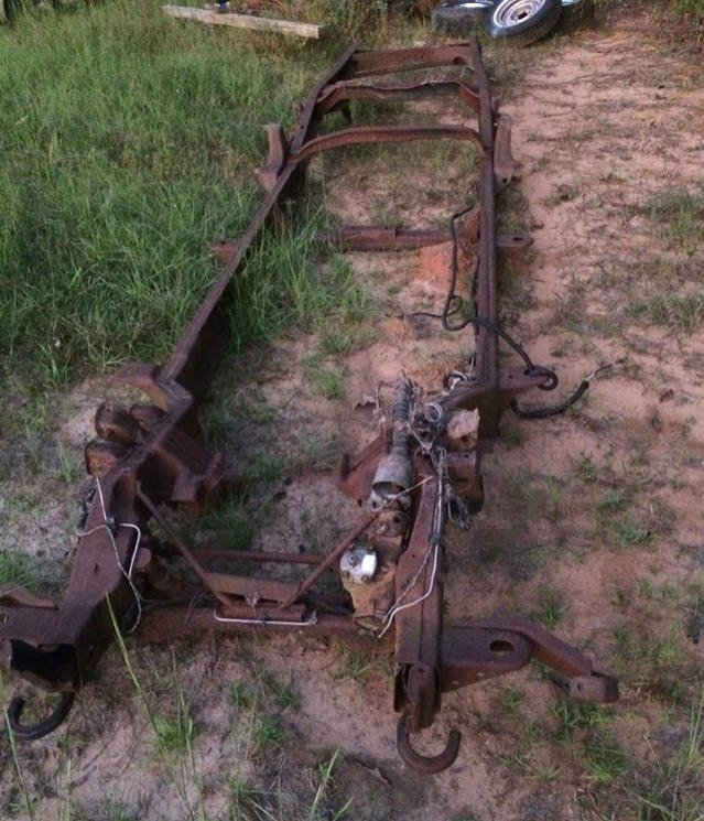

A factory CCLB 4wd srw frame I have. Have all the front suspension etc. stripped it to blast, then sold the GMT400s i had, so no longer going to use.
