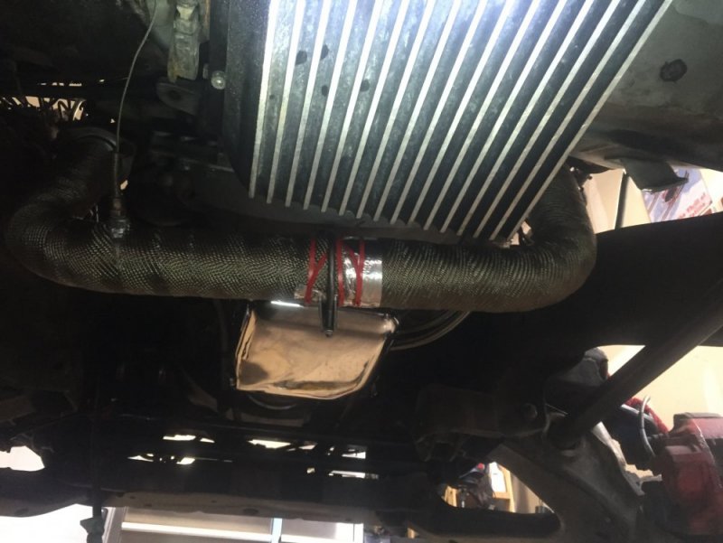

Here is the wrap:
Design Engineering 010122 Pipe Wrap And Locking Ties Kit 2 in. x 25 ft. Tan Pipe Wrap And Locking Ties Kit https://www.amazon.com/dp/B00B82X9NY/ref=cm_sw_r_cp_api_i_5julCb3VP22VF
Here is the silicone spray. I have used it both with the wrap and by itself with good results.
Design Engineering 010302 High-Temperature Silicone Coating Spray - Aluminum https://www.amazon.com/dp/B000MY1RB0/ref=cm_sw_r_cp_api_i_QnulCb0XJAQXD

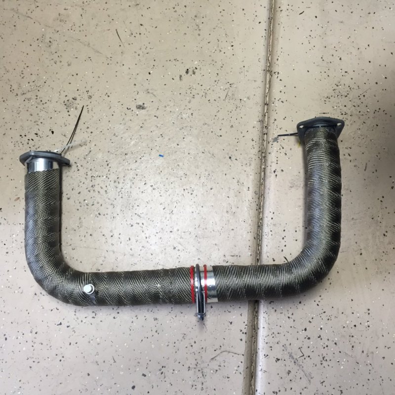

Here’s my downpipe adapter after 4 years of daily driving and a few (cough) exposures to 1300 degree EGT exposures....of course that temp is pre-turbo, but still.

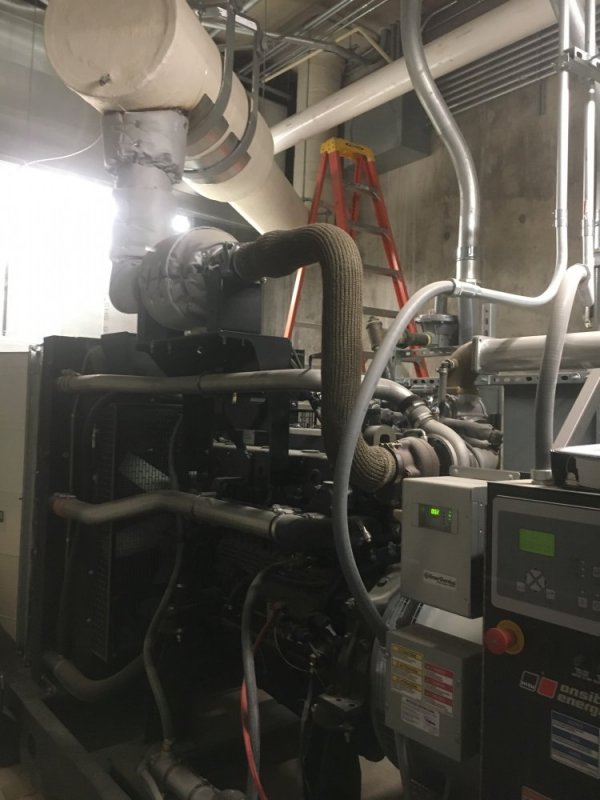

I actually thought of this the other day. I had to get our insulators to insulate the exhaust on the generator that we put in at the hotel. They insulated the 6” sch. 40 pipe from the turbo back with what your talking about and they do make the stuff as small as we would need. You can get different thicknesses of it. I’ll try to remember to get pictures tomorrow so folks can understand what we are talking about.

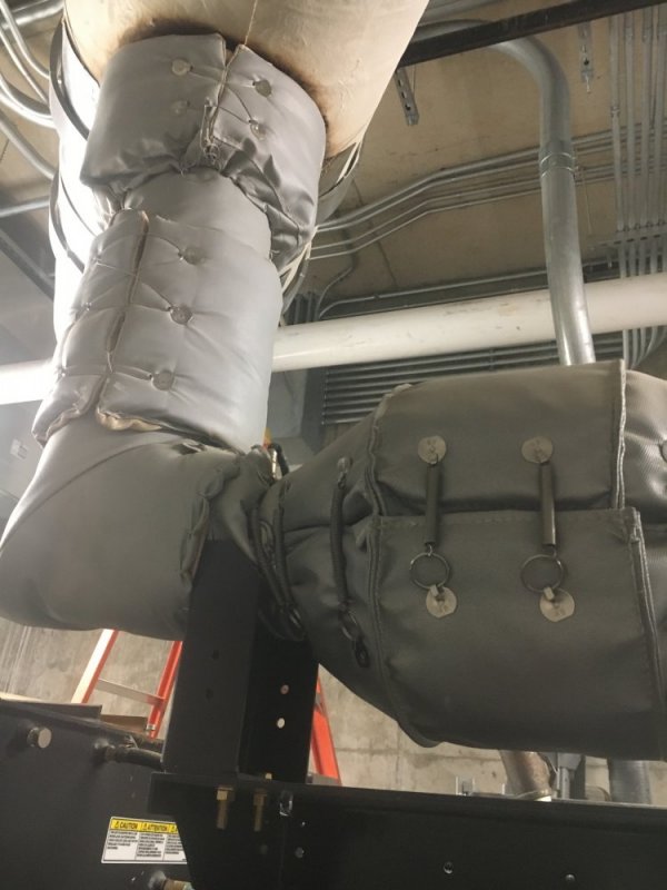

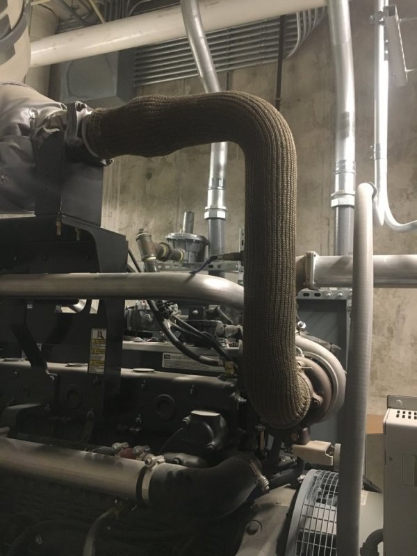

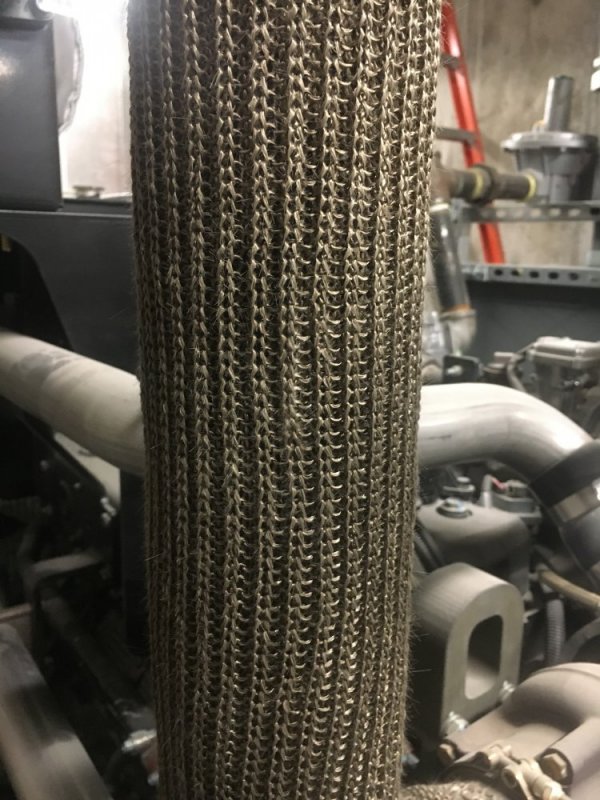

Took me a while to find this thread cause I couldn’t remember the name of it.
I took some pictures of the sock wrap and the blankets with the grommets in it and the insulation that you probably wouldn’t want to put on a vehicle but it sure does work for generator exhaust.
The first picture is like a sock. It just slides over and it’s pretty tight.
Here’s the blanket with the grommets. You could get a blanket with different material so it could handle the outside environment better. 34EE6495-FBAA-4314-9EBD-5A18EF7556C0.jpeg61330591-CCEA-4873-8B73-36DF18D5F859.jpeg

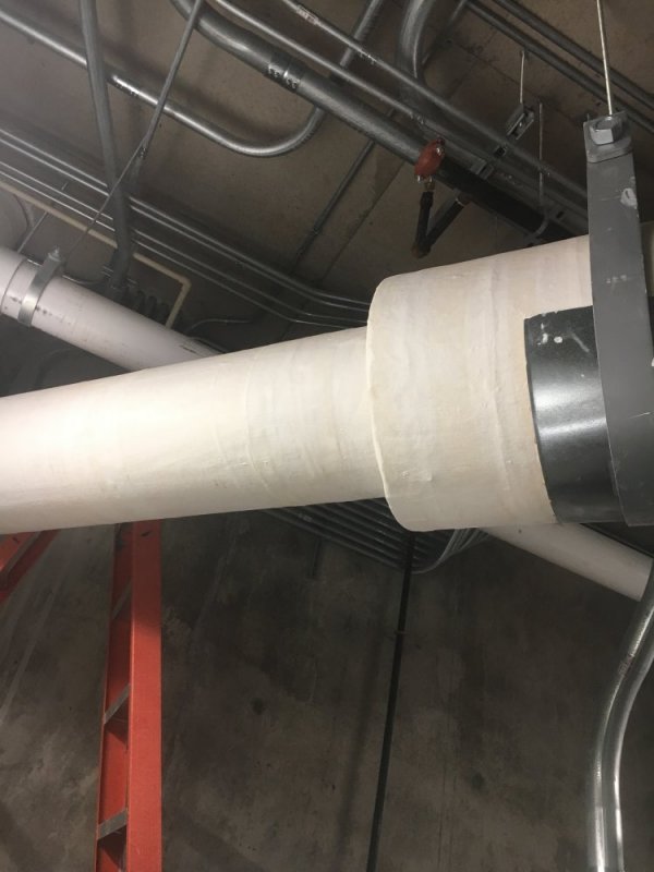

Insulation that you probably wouldn’t want to put on your vehicles exhaust but it would definitely hold the heat in if you did. It’s a wrap kinda like a painters drop cloth with a coating on it that dries hard as a rock.
