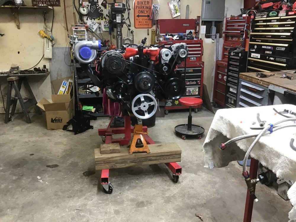

Thanks SnowDrift. Very nice and informative post on your build. Isn’t this site great they have a lot of knowledgeable guys on here. Here is my new Optimizer I’m putting in my 95’ Dually. IMG_0206.jpegI hope I don’t regret sending it to TSP to do his magic. I am trying to address the heat issues with a high volume WP and a Duramax fan upgrades. Also a fluid damper from Leroy’s. Where did you source your oil cooler? Also I can’t find an OE trans. cooler either. Don’t want to chance cleaning the old one because I had the trans. rebuilt.

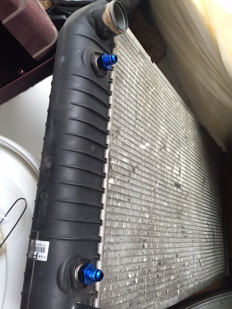

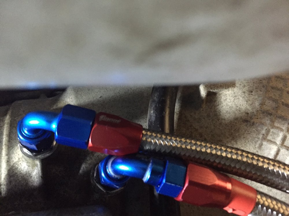

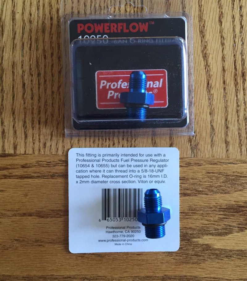

Built my own transmission lines. 3/8” braided and 6 AN fittings. Then, the 6 AN to whatever the transmission, cooler and Radiator fittings are. I don’t trust my recollections so here's a couple of pictures.
90* fittings at the Transmission
Radiator Connector

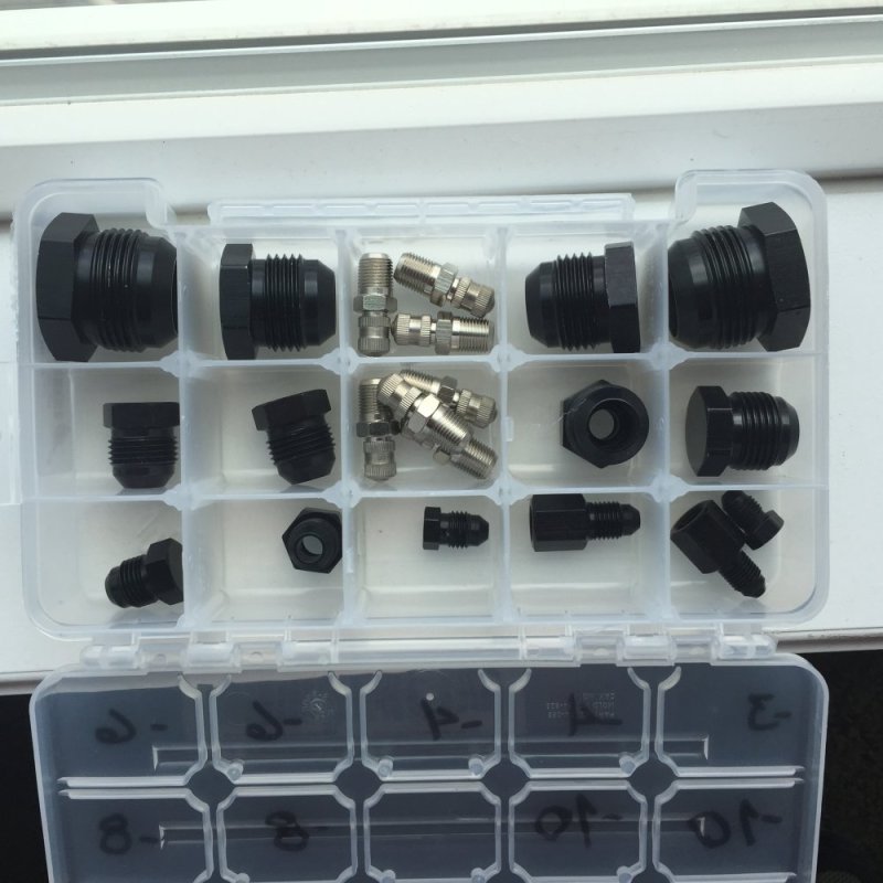

Got a fitting test kit to pressure test the completed lines before installation along with their line cutter but, not a fan of the cutter, still need to wrap with electrical tape before cutting and putting on the fittings.
