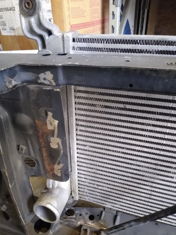

I don't know what year intercooler that you have but the one I have is a 2004. It sticks up an inch or so above the core support. I've searched and searched for pictures of your install but they seem to be gone everywhere. I've got a spare core support that I've been trying to fit this stuff in before I cut on the one in my truck. Here's a picture how much higher than the core support it is.IMG_20210208_142747045_copy_768x1024.jpg
