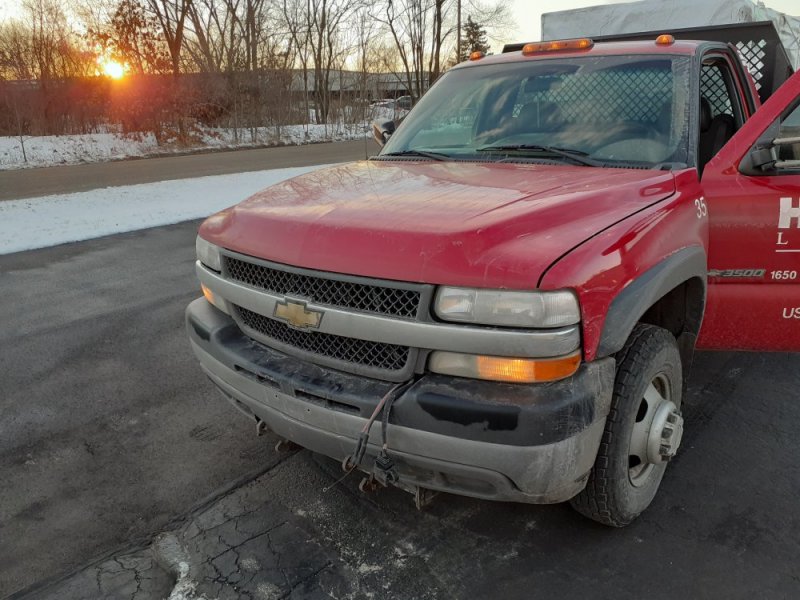

It is a regular 3500 as far as I can tell, at least it is not badged as a HD;Negative, if the fuel levels dofollow what it expects from them, it will revert the gauge to empty. All you can do is to install a resistor so it thinks the rear tank is always empty, then it will show roughly a half tank when the front tank is full.
Just dawned on me you said it's an 01, which body style 01 is this? Does it look like a 88-98 style truck or a 99-06 style truck? Is it a 3500HD or just a 3500? If you have the 99-06 3500 body style truck all the info I gave is correct, if it is the 88-98 3500HD body style none of the info I gave is correct.
