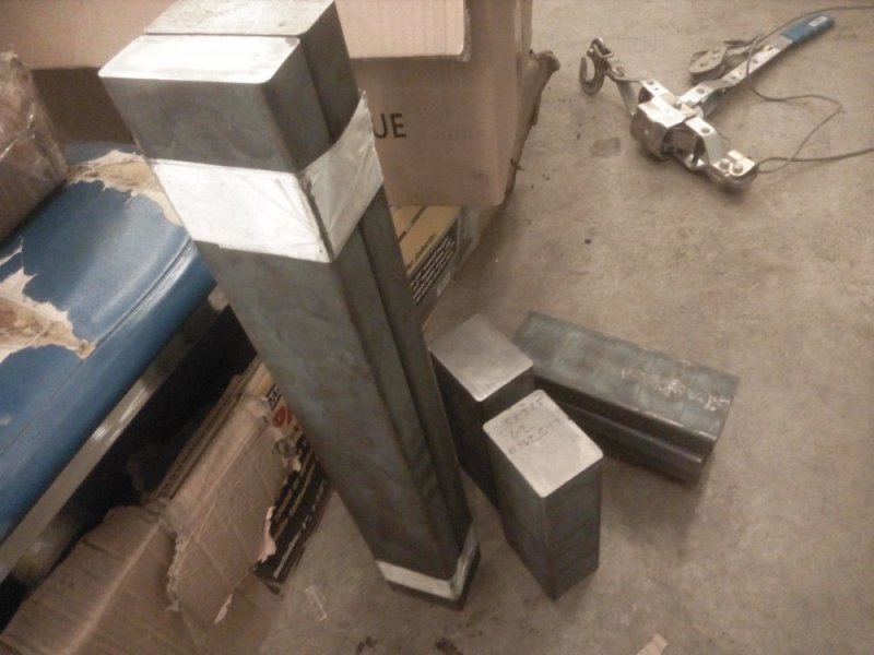

The one I made replaced the main caps so obviously had to be bored. I’m sure it helped but that was back when I was rich and famous- haha.
