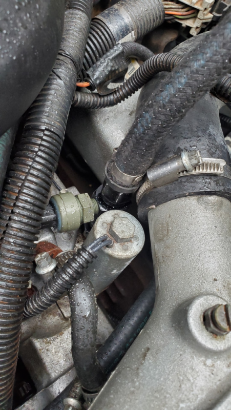

I am assembling the components to install a fuel pressure gauge into my H1. I've got a mechanical lift pump going into my DS4 so I'm really keen on getting a pressure reading going into the IP. I have a FTB mod already installed.

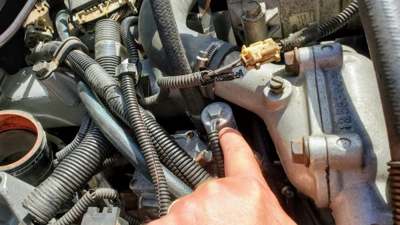

I've found a stainless AN6 Tee that I can use to put on the inlet port on top of the IP. Problem is that the shutoff solenoid is firmly in the way. If I can remove it temporarily while I screw in the T, I'd be golden.
Unfortunately I'm not familiar enough with diesel injection pumps to know whether this is ok to do or not. Can I remove the solenoid temporarily - then once the T and sender and fuel line is re-attached - put it back in? Is there any set of procedures that I need to follow in order to do this?

That’s the best way to install a pressure guage on a DS4 that I’ve seen. Mine comes out the top of FFM
Sure thing - this is the fitting I'm using. Note that I do have a FTB mod as well.
Yes, I know it's aluminum and it's not the best - but the rest of the fuel line hardware is aluminum already... Another H1 owner posted this fitting on the HML, but said that when he tried it on his truck, the vibrations of the engine kept loosening it up. After installation, we ran the engine at idle for about 30 minutes and it didn't move. It will be something I keep a keen eye on over the next few months - especially as the weather turns colder.
