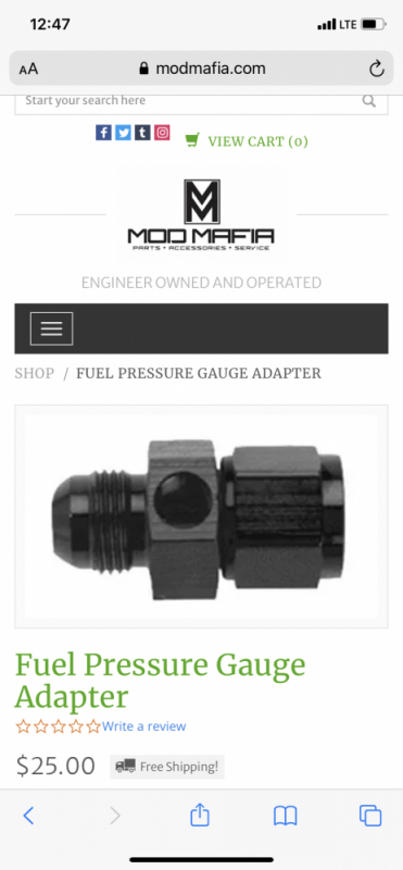

I been hollering long enough that Mark at Mod Mafia finally sells one. Not sure if he found an existing one that happens to work, or is having one made. Either way, here it is. Since there is no current vendor here that offers it, I think it’s ok to post a link. Gonna do a picture also just in case. I haven’t used one, since ds4 is the devil, and I only one db2 rigs.
is this for the DB or DS pumps? I could be wrong, but this looks as if it has #6 jic or -6an male and female ends. I suppose an additional #4 male o-ring boss to #6 male jic adapter would be needed to be able to use this fitting along with a female #6 jic to 3/8" hose barb for the DS style?
Thread says its for DS4, site says it's for 6.2 or 6.5, which suggests both DB2 and DS4 as 6.2 was only DB2. I am curious as to where exactly it's supposed to thread in, as the DS/DB pumps have different inlet fittings to begin with, and most hot rodded DB2 pumps have a nose cone threaded for a larger ORB fitting than the puny 1/4" brake line type fitting on the GM DB2
That would be for a ds4. They are not good at proper labeling.
I am not sure if this is stock 5/16 or for 3/8. They just posted it today on thread, I think the rushed getting it online because there are several folks on the hummer forum looking to add the pressure gauge currently. I think they will soon get labeling corrected- just call them with questions.
Still surprised no one here ever did this yet. I guess $5 a fitting profit isn’t worth a lot of effort, but I figured a complete kit would be desirable. Just my theory.

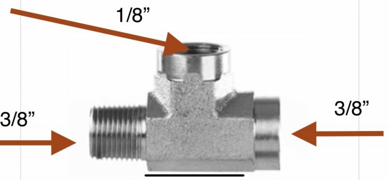

@DieselAmateur Db2 just needs a “tee” that has 1/8 top female, and either 5/16 or 3/8 on the male & female ends that go straight through depending if you are stock fuel line or upgraded to 3/8”. Use stainless preferably. I usually pop into a shop and tell them what I need, they show me a few options/ prices and I get one. One like this should be in the $25 range. Just install it in between the existing barb fitting and ip inlet cone.

The fitting Leroy sells is cool, and way better than using nothing. But the bleeder screw is pre filter, and obviously pre fuel hose to the ip. What I advocate is using a fitting like the one Mod Mafia is selling that will go in between your ip and existing line.

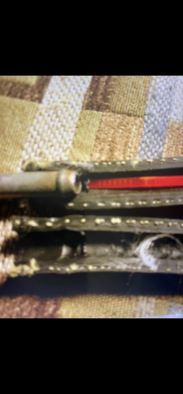

Then you mount the sending unit right there. This will read the actual pressure at the ip. This becomes important when the fuel line gets damaged before the ip. If your line just before the ip failed like the one in the following picture, what happens is you will read great pressure where your current gauge is tapped, or if tapped on the wif drain line. If you did volume flow test- plenty could come out. And before you know it you are installing a new ip. Unfortunately the new ip will mess up also, because the hose is still bad and you have no idea it is $5 worth of fuel hose.
What my plan is this time around is have a pressure gauge sending unit at the ip inlet by using a T like above. Another sending unit pre filter like how yours is (except I will probably replace factory ffm) then the two wires go to a switch and one wire from the switch to my gauge. So switch in normal position and I read the ip pressure. Flip the switch and I read pre filter pressure.
Simple flip of the switch and by knowing the normal difference between the two, I can tell when I need a fuel filter. If I loose pressure, flip the switch and see if filter or fuel line is plugged or if no pressure is coming from the lift pump.
When I worked at the dealership- in the gm/ stanandyne testing kit- it had a fittings like these 2 tees (along with other parts of course).
Before condemning an ip under warranty- installing one of these fittings (that had a quick disconnect on the end) and getting the readings was required. The fitting was longer than the one in this pic that MM is selling, but no clue why they made it so long.

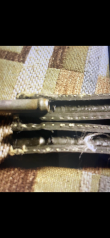

But here is a few pics, the two pics that show the cable tie as a pointer to the flap which was intermittently blocking flow for this guy who seems to not want to share it here- replaced his ip because he had “good pressure to ip” when infact his failed right at the barb fitting of the ip. New ip, same problem. He is not alone, I have seen this many times- and TWO different members here not counting the guy that sent me these pics- had this happen but didn’t want to admit it on the forum because they feel silly over spending big bucks over a few dollar hose. Then the count on the hummer forum is TWO. so that is 4 people in the last few hears that did ew ds4 and didn’t need it. I got bit by this on a db2 way back, His (the picture supplier guy) was db2, but when this occurs I have seen it both db2 and ds4- and it seems always at the ip fitting becomes intermittent. When at the lift pump or filter- then plug constant- so maybe something about the thing John was saying has different effect close to the ip- he obviously onows more about ip than I ever will.
Note the condition of the rest of the hose. Only the thin inside layer is coming apart. The rest of the hose looks and feels absolutely perfect. No signs of damage that would ever be suspected. I can’t remember how old he said this hose was/ mileage in this picture- but my experience seeing this so many times, I would suspect 35,000-40,000 miles.

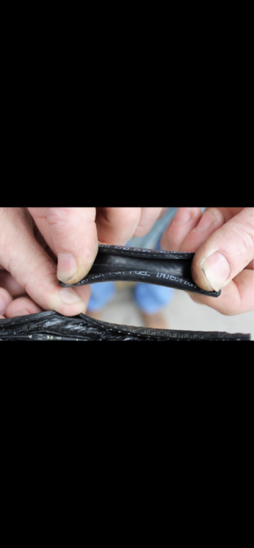

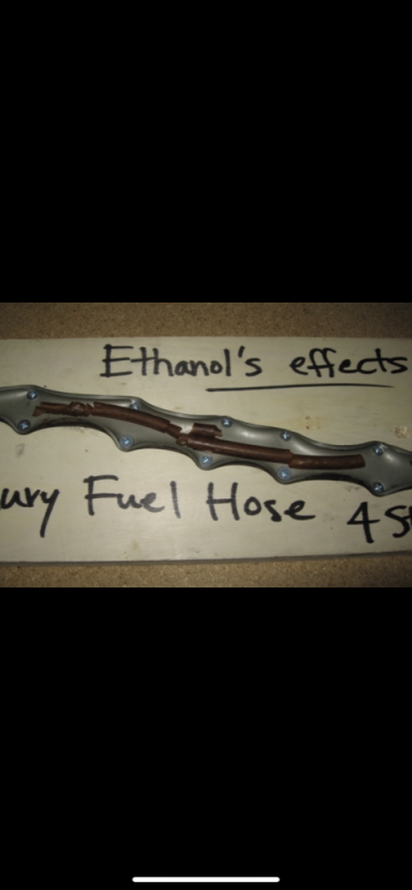

The other pic random shot of ethanol problems to fuel line, other shows proper condition.F0D6384D-AA4C-4AE3-A36C-C4D51B1FA8F8.pngC61EFD15-68A2-42FC-A430-926395D85A44.pngF675F490-E756-4306-A388-6CA3259DCBA7.png28F52D42-3DF5-485C-B03E-3D27FF90D1F8.png
Well thats not a proper hose (fuel injection hose) so yeah its going to fail possibly. Even so Ive never seen or heard that it was even a thing. Use the correct parts and should never have a problem.
