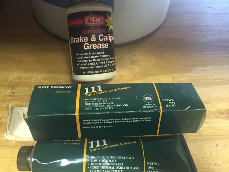

My number 2 choice after the antisieze is this stuff. Not the 111 silicone, that was a pic for someone else. This brand brake and caliper grease has teflon and graphite in it so it does ok.
CRC # 05350.
