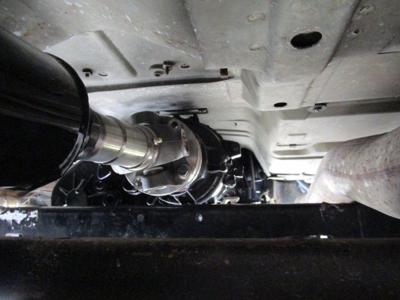

Today, having a new 3.5" dia. driveshaft w/slip shaft & companion flange, built for my GMT425, 59.25" long, 14 bolt ff to t-case flange.
Then I have to finish the 9.25" IFS diff w/ARB locker and a new shaft for that, trying to convince boss-lady, I need the RCV performance axles for that too.
