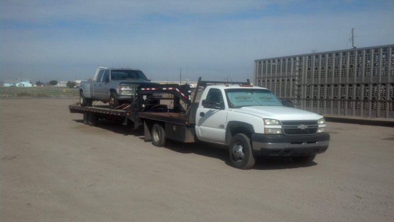

I drug home another one. :) 95 K3500 CCLB DRW 6.5L 5spd 4wd.
It has about 250K on it, story goes he was just driving along and it just shut off, never to start again. Owner claims to be a good mechanic and has had a few 6.5Ls over the years and claimed it has to be the IP
I cracked the drain plug, normal looking black oil, no coolant in oil. only about 1 gallon low on coolant, (sat 5 years roughly) oil cooler lines look good on block, minor seepage at crimp, and the motor was full of oil and rocked over by hand, and starter bolts and brace were intact, so I paid the guy and drug it home.
Now, its home and I'm trying to get the ol sow to fire, It would be nice to drive it off the truck, but not a requirement. :)
