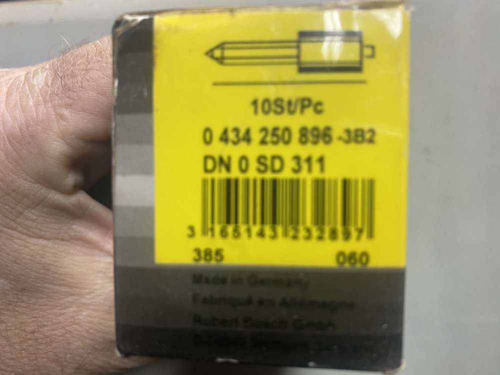

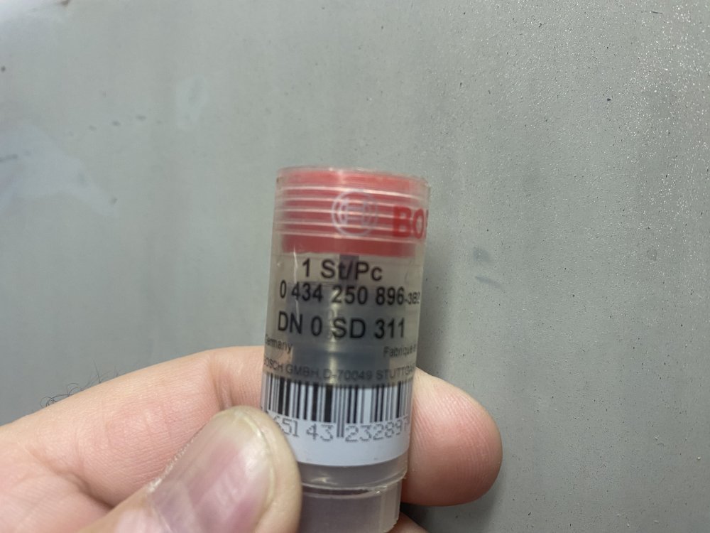

I'm looking to buy some 311 injector nozzles, the last set I bought on ebay but I can't seem to be able to find genuine Bosch nozzles. I don't have the Bosch part number so if anyone has that it may help.
Any help is greatly appreciated.
