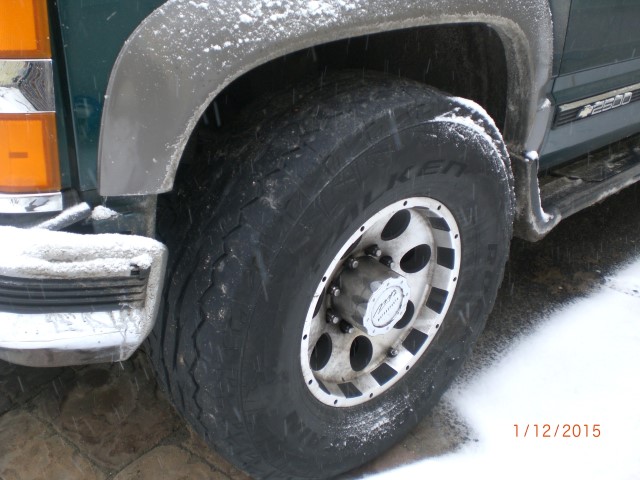

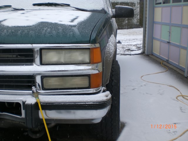

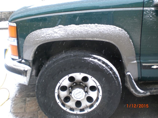

We have a '95 Suburban 3/4 ton 4x4, and when I bot it 3 years ago, I put on MB Razor 16" wheels and 285-75R16 Falken WildPeaks. The tires stick out past the fender flares, and the tire spray covers the side of the truck with whatever I drive thru, and I'm not wild about the look-wideCIMG5639 (Small).JPG CIMG5639 (Small).JPG CIMG5640 (Small).JPG CIMG5641 (Small).JPG CIMG5642 (Small).JPG CIMG5639 (Small).JPG CIMG5640 (Small).JPG CIMG5641 (Small).JPG CIMG5642 (Small).JPG stance.
We want to put winter tires on as the Falkens are nothing special in the snow-ice. A tire place told me I should look for "0" offset, and most rims are -6 offset. The 6 refers to MM's, which is not quite 1/4". Will 1/4" really make a difference to bring the wheels in? The -6 are much more common, and less expensive. I suppose I should just put on rubber fender flaps... I looked underneath, and I don't think I'll have tie-rod or intercooler interference, yes, it has an intercooler under the bumper as it came from Phoenix.

The wheels in the Pics above are -6, so you'll be in the same boat. To double check, pull one off, and the offset will be stamped on the backside of one of the spokes.
With a 0 offset VS -6, the 0 offset will only be .2" more tucked in than the -6 offset. So, you prob won't even notice a difference since it's less than 1/4".
What about larger fender flares? I know you don't like the wider look, but it will tame the look of the tires sticking out and stop al the body spray.
