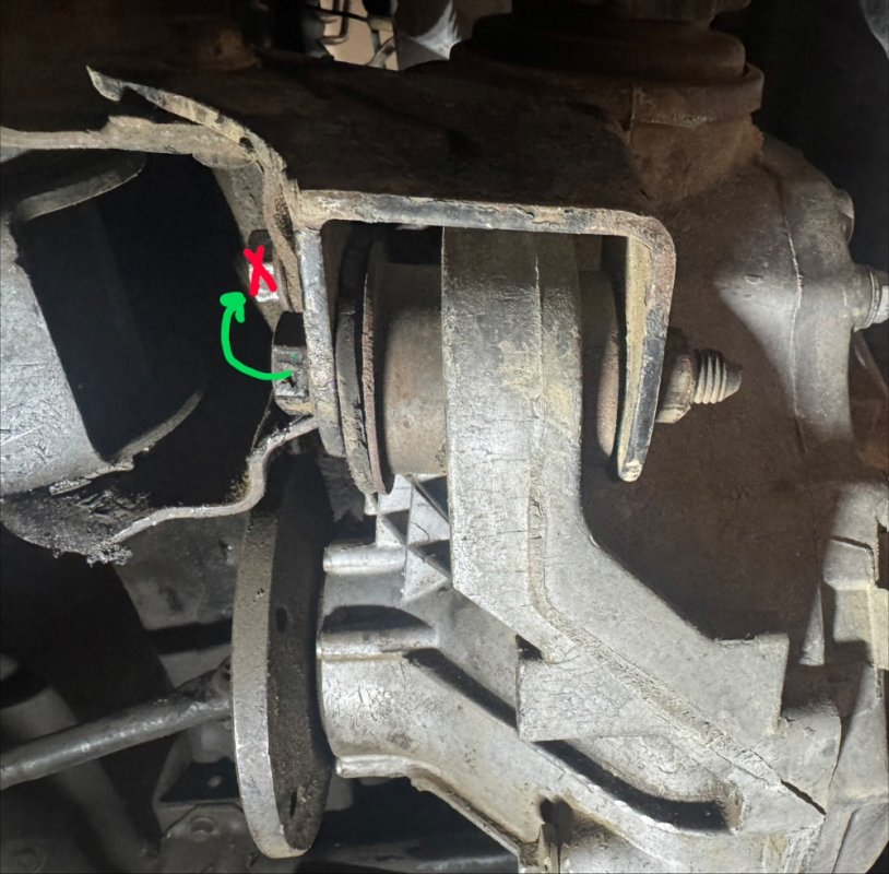

Aftermarket bracket to suspend the differential. The green arrow shows OEM Bolt Location. Red "X'd" bolt will be removed and the tab probably cut off so I can reweld things.
I figure I'll repurpose the drop kit's lower mounting bracket instead of waiting on weather or others. Remove the two bolts marked with a Red "X"
After determining how much of the aftermarket bracket to cut off, the Green marked OEM bolt go through the OEM location on the suspension and clamp things together so I can then well things back to the frame.
I'll have to recenter the bushings on the differential, of course, before finalizing anything.
