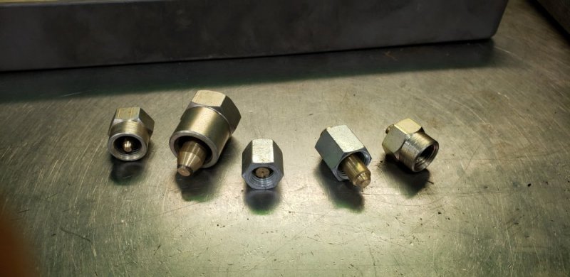

Here's another idea. Have your mechanic block off each bank one at a time with a block off plug and see if rail pressure comes up to spec while cranking.
I have a block off tool for each of the big 3 common rails. They work great to isolate problems. You can block off injectors one by one or the whole bank if needed. Just remove the injection line and screw on the plug.
