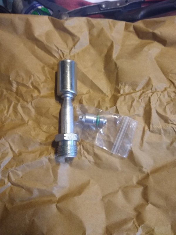

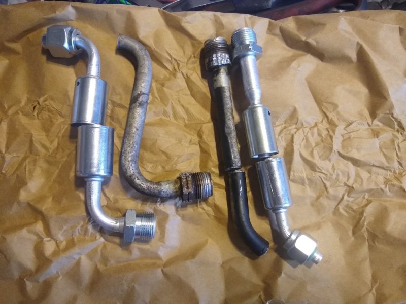

I have 2 ideas in mind for how to connect the UAC to my stock lines. Either use the metal lines off my old condenser and have adapter fittings welded on, ir coldhose shows metric fittings to connect to my old lines and then I can use a #8 & #6 fittings to connect to the UAC. I will figure that out next week hopefully.

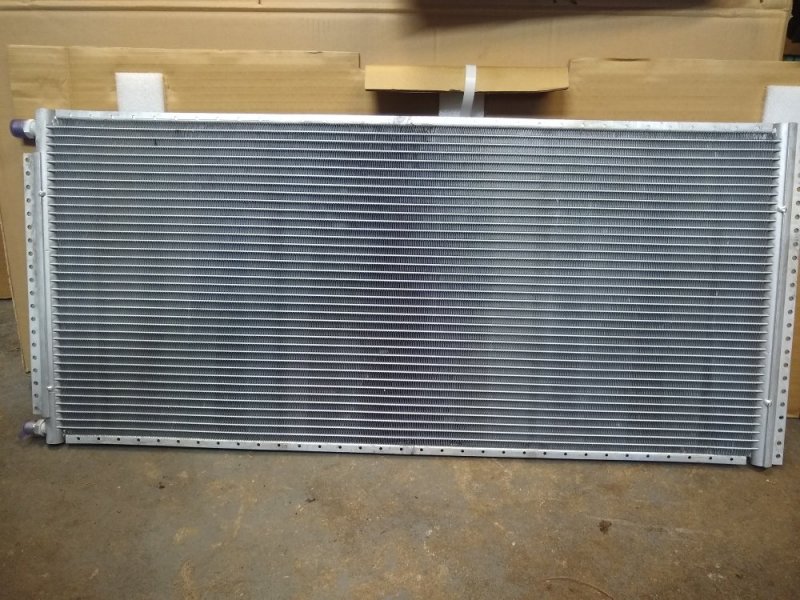

The UAC CN1635PFC

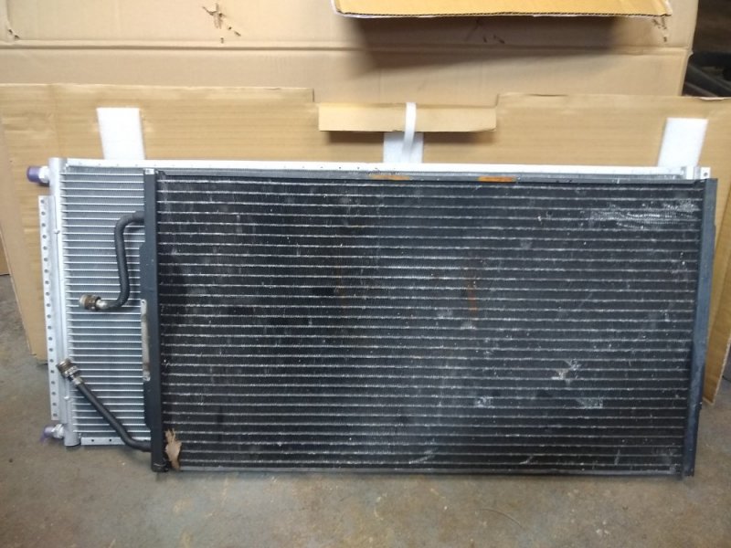

A stock 94-02 single air parallel flow condenser(I don't have a dual air serpentine left around) for comparison.

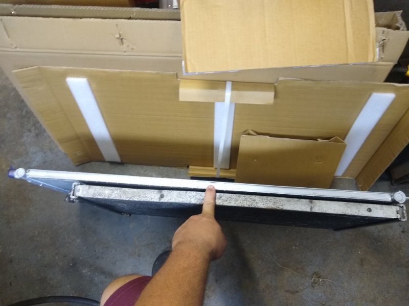

Thickness difference.

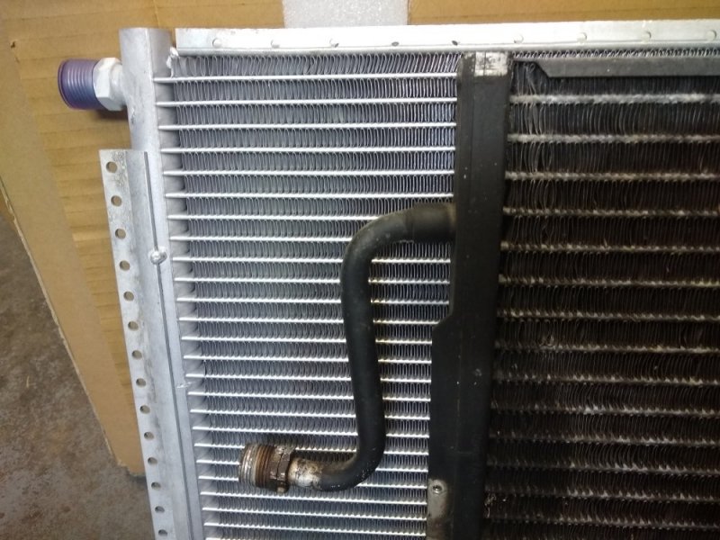

Modern parallel flow design with 8mm tube spacing. You can see how many more cross tubes there are in the modern cooler. And the UAC has universal mounting rails on all 4 sides.
Here's 1 setup that will work, but in this configuration I lose the pressure port that 95's used for the high pressure activated switch that forces the system to inside air when the high side hits 370. I can use a short piece of hose to close couple them, and it will be a REAL close match for the stock hookups.
Losing the high pressure switch shouldn't be a big deal, but if I feel bold, I also got a weld in m10x1.25 switch port I can add in to retain the switch with this setup. This fitting has enough tube I can braze it into it, but I'm hesitant to mess with this tube when it was the ONLY one I could find in the whole USA.
Or my last option is to cut the tubes off my condenser that is in the Suburban now as it has the switch port on them, and braze fittings into them like this(these tubes are for demonstration only).
So I have options for how to hook it up, just have to pick one and go with it.

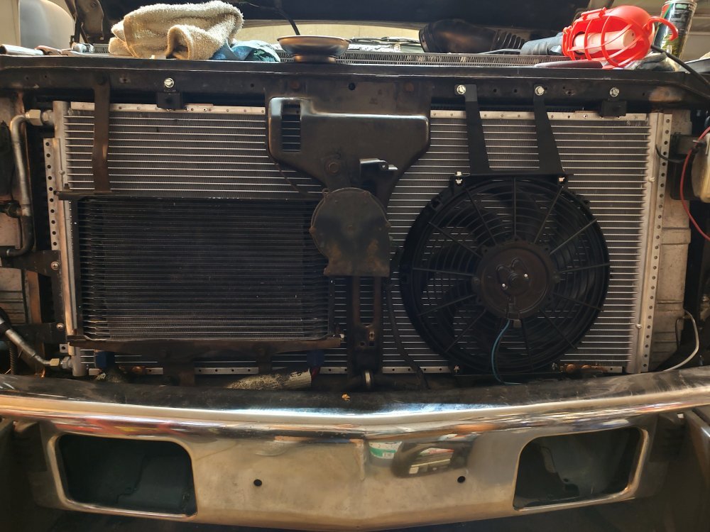

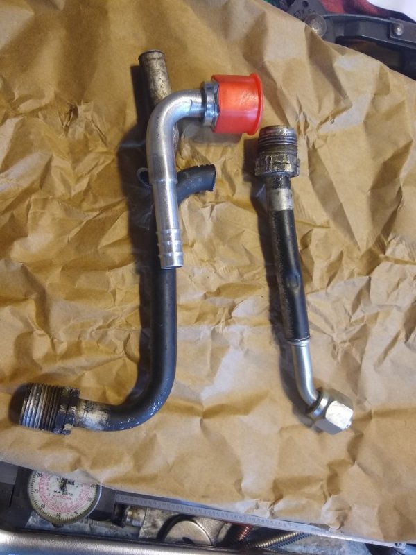

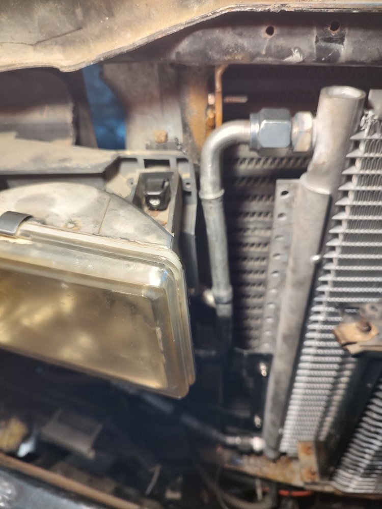

Guess I need to update this post. I did finally get around to getting this condenser swapped in. I ended up using a combo of tubes & brackets off my old condenser, an old evap, and some aluminum ac hose ends to build adapter lines to connect the factory lines to the condenser so that nothing is chopped/hacked up. I used some of the mounts off the old condenser & fabbed up some new upper mounts that hook to the new condenser, but use the stock mounts still. So far it seems to be working VERY well.
I still have to tweak the charge as the new parallel flow condenser holds considerably less charge than my old piccolo condenser, or the stock serpentine condenser did. So far it runs really low head pressures idling, I was only running about 200-205/32-35 idling with the front on fan 3 and the rear on medium. I don't know if this is a combo of the new technology condenser, or the fact the new condenser takes up ALL of the real estate making it so the air has no choice but to flow through it.

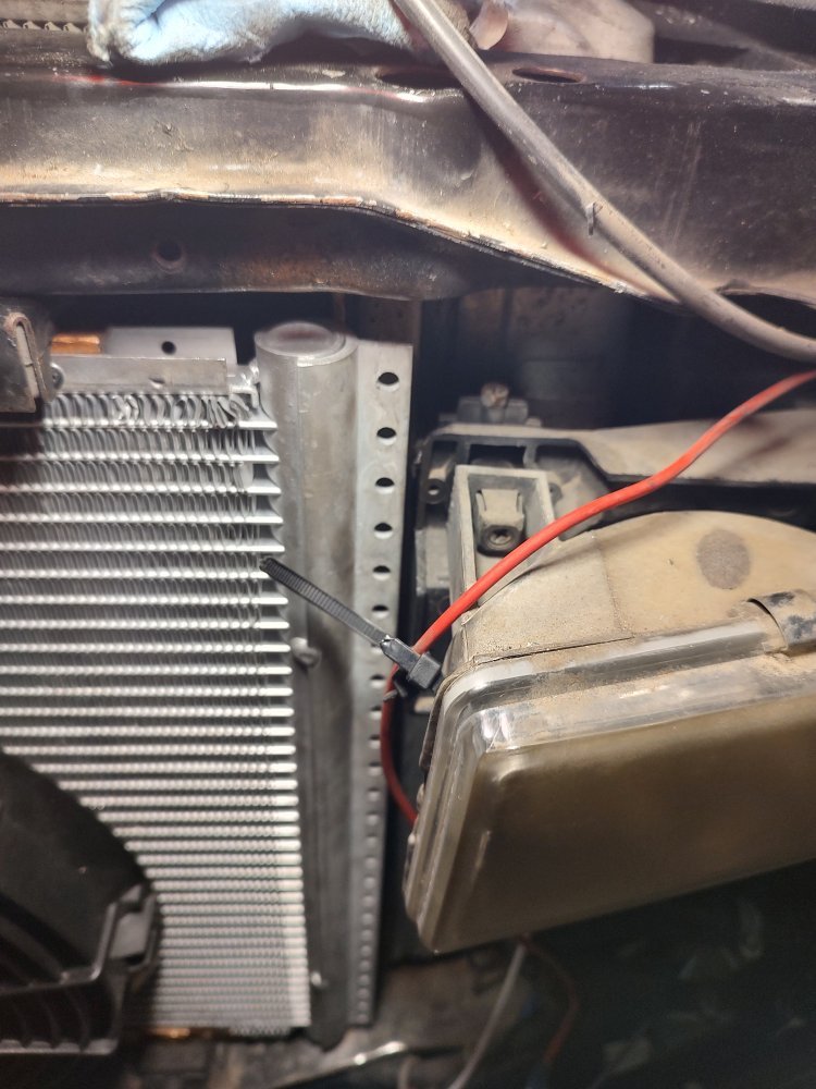

As you can see it takes up ALL of the room, I ended up having to relocate my power steering cooler to inside the bumper because there isn't even a 1/4" of clearance on the headlights.
As you can see, there is not much room at all left. And you can see how I built my lines up out of spare pieces and an aluminum hose end brazed together.
No room left for a power steering cooler.

And for those interested, the al822 brazing rods are EXCELLENT for brazing with. With just a little practice I figured out how to use them and make nice bonds. They do leave a nasty flux powder you have to remove afterwards though. And you will also need a swaging/expanding tool to join the pieces of tubing as they have to slide together with a collar to braze to.

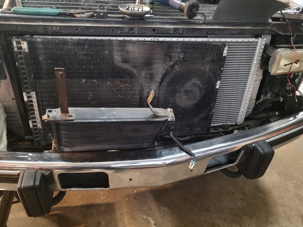

@THEFERMANATOR That looks awesome. I couldn't help but notice that you must have relocated your oil cooler to install a electric fan. as some point I plan to attempt relocating my trans cooler to fit between the condenser and the radiator. I was reading back in your thread and also looked at the part numbers you mentioned to me, I will at some point need to replace my condenser and the liquid line going up to the evap since someone before me chopped off the portion where the orifice tube installs and used one of those repair kits for it. I have been wanting to get my AC colder for a while. right now I can get it to blow right at 50 deg out of the vents, but the cab really never cools down. need to gut and install some insulation and sound dampening solution.

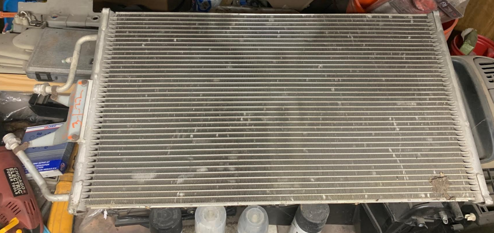

anyhow since my rig is a 95, the one year only that had several diferences compared to the other years, what would be the suggested condenser part number I should go with? I have one that I pulled from a scrap yard that looks to be a parallel flow unit I was going to use, I will have to post up a pic of it. I think it's the same width as the factory one I have installed, but has the high side sensor port and the orifice tube section attached like mine should have.
I dug the condenser I have out and took a pic. (don't mind the disaster in the garage) it looks like it is a parallel flow unit. can y'all confirm from the looks?
That is a parallel flow, but not the modern design. Fyi, parallel flow condensers cannot be properly flushed, so if there is ANY question about it's condition, replace it. The apdi/agility 7014544 is an excellent factory replacement condenser and is what I run in my Tahoe that puts out refer temps out the dash vents.
And mine is Duramax swapped, so no external oil cooler, it's built onto the block at the oil filter housing.
