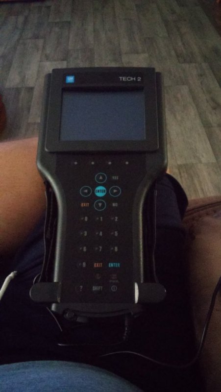

I've been on the fence for awhile, but I seen one of the clone Tech 2's with Candi module for $225+ shipping(came out to just under $268 after shipping and handling/customs). It came with a clone/chinese tech 2, data cable, 12 pin obd1, 16 pin obd2, a couple of other plugs for Saturn and I believe Opel, Candi module, cigarette lighter plug, a/c outlet plug, battery clip power cable, ethernet hookup cables, tis 2000 cd, and a documentation cd. The Tech 2 covers Saturn from 91-13, and GM from 92-11 and several others to 13(you need an mdi to do 14+).
I've only had a chance to use it on my Burb, but I've had ZERO trouble accessing ANYTHING in it. It has zero trouble going into my TCM(alot more than I can say for EFILIVE's V2), links right up to the ECM, read my 01 BCM and cluster module on the obd2 side as well. Then I swapped over to the obd1 side and had no problems going right into my abs and airbag controllers. The main reason I bought it was obd1 is a bastard child in several ways for 95, and only a factory tool can access my abs and airbag. The tech 1 requires a special adapter to connect to the abs where the tech 2 does not, used tech 1's with the abs adapter will set you back close to a grand for a nice one, and I don't need to read GM's older than 92 that bad(or I can use aftermarket cables and tuner pro for about $100 if I really need to).
So far the only complaints I have are the cigarette lighter plug doesn't work(has a break in the ground, I'm contacting them about a replacement), it has the common issue of shutting off and restarting when you crank the vehicle that plagues these clone units(it's a known power supply issue and can be fixxed most say), and some of the menus regarding vin breakdowns are not completely marked(a small price to pay for getting one for $268 vs $4K+). Otherwise I LOVE this thing.
Here lately my EFILIVE has been giving wild balance rate readings on multiple trucks(mine with the sac nozzles was showing -2 up to +1.6), and the tech 2 shows them being almost perfect(-.6 to .5) like I had hoped from a $2800 set of s&s sac's. I'm going to see if my neighbor will let me connect to his 2011 yukon so I can verify the candi module works, but so far everybody says they've been solid.
If you're like me and plan on keeping your vehicle, at this price it makes sense to pick up a scan tool to read your vehicle.1017181550a.jpg
