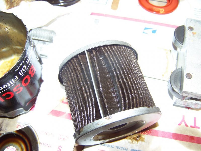

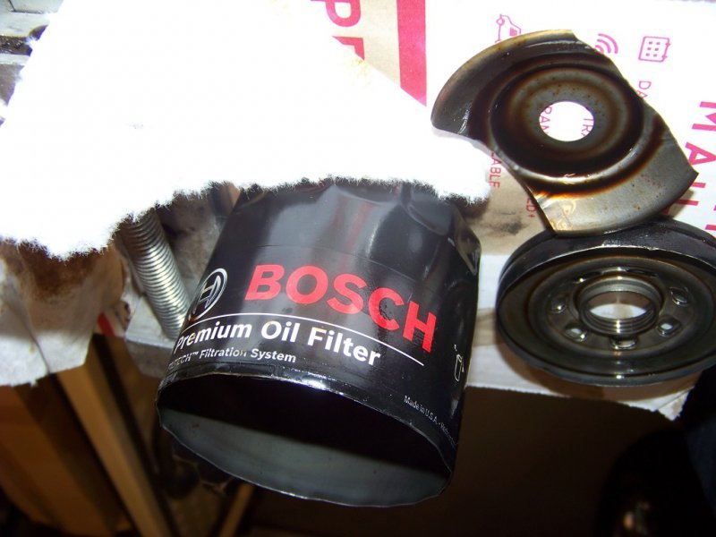

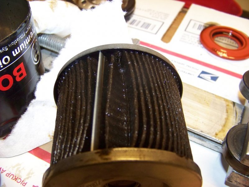

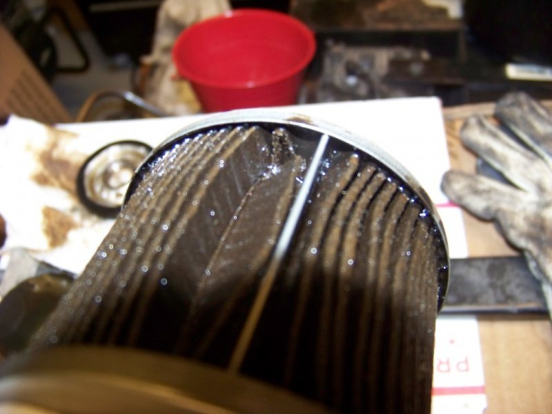

If you have any Purolator oil filters including brands they make NOW is a good time to remove it from your engine for something else. You can imagine my surprise when I cut this Bosch oil filter open and a pleat was torn on both ends. No I didn't break it, Link: It's a common EPIC Fu#k up for the brand and the companies have their heads buried in the sand. I ran it because the M1 filter wasn't in stock and it's NOT a FRAM. Less than 10K miles on oil changed by the GM oil light and I am not happy with the condition of the Mobile1 oil. 2008 5.3L V8.

Probably Mike. But its worth a shot anyway. It is hard to tell by the photo, but is the filter media cardboard, celulose, or something stronger like wire backed synthetic?

The spread sheet on BITOG showed 2009 mfg year as the most common failures. Seems since it appears to be the pleat beside the seam that fails I wonder if that is where they hold it when cutting or other process and a stress concentrator. Pretty clear trend if it does correlate to a process.

The antidrainback valve is silicone and the bypass valve is a work of art. The media is brittle (and is said to become brittle with age online). My biggest concern is the 'sludge' looking stuff that it needed to filter. For the application there is a longer filter that will fit I need to switch to.
