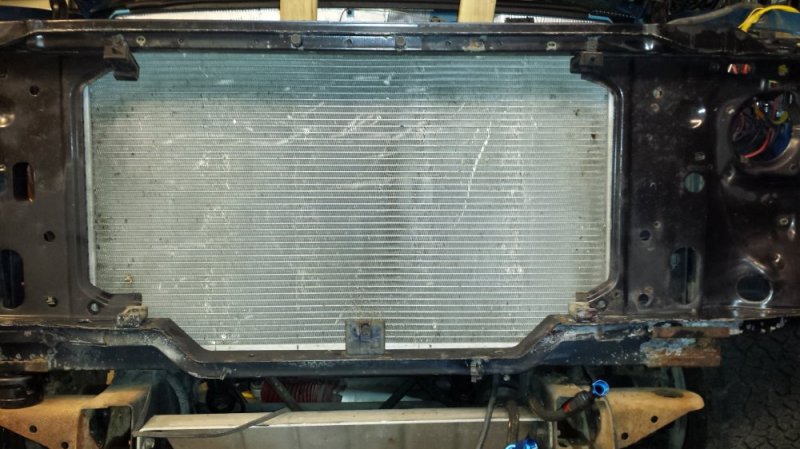

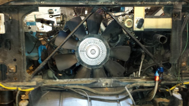

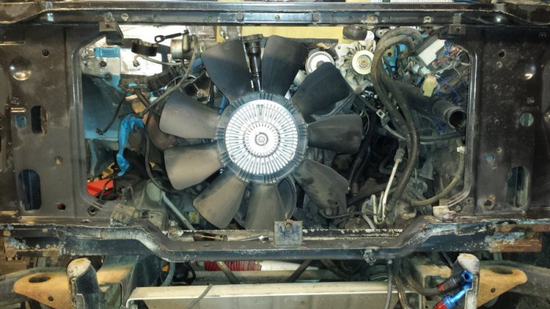

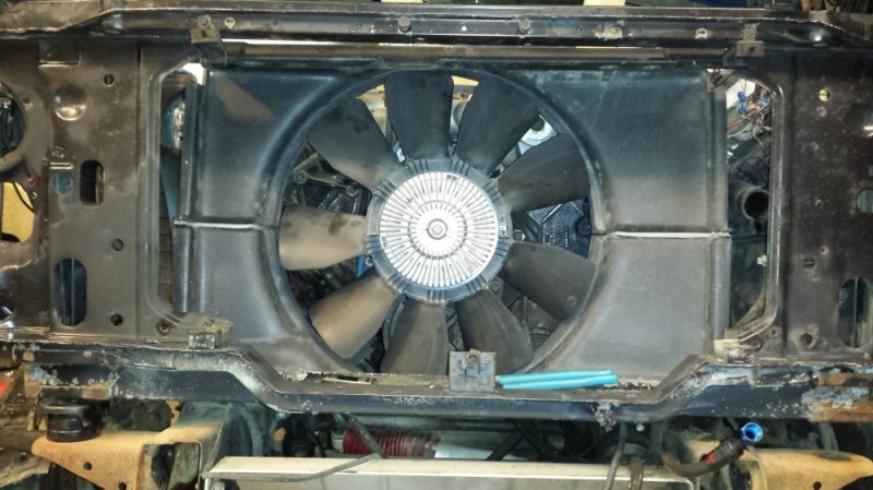

A 3 body lift - stock core support.jpg B 3 body lift - 3500HD core support.jpg C 3 Body Lift - 3500HD core support - stock shrouds.jpg I'm doing a 3" body lift for several reasons: stance, better downpipe path, & a little more room (vertically) to fit in an LB7 Duramax intercooler/rad stack.
As this thread discussed the 3500HD core support, thought I'd add a few pics showing the relative fan/core support/shrouds alignment with a 3" body lift: stock core support - vs - 3500HD core support that I'm modifying extensively to fit the intercooler.
Not certain yet if using the stock shroud will work out, but using the 3500HD core support can definitely improve the vertical alignment of the rad/IC stack & fan/shroud.
View attachment 45970 View attachment 45971 View attachment 45972 I'm doing a 3" body lift for several reasons: stance, better downpipe path, & a little more room (vertically) to fit in an LB7 Duramax intercooler/rad stack.

Here is a picture of the stock rad setting in the taller HD core support. Note the top of rad no longer show above the core support. Along with that dip in the bottom core support rail, it appears air might have a straighter shot to the rad.

As the 3500HD trucks are on a different frame, I think the front bumper does mount lower, relative to the grille on them. The HD's core support is extended down not quite an additional 3" (compared to our stock core support) where it meets the body bushings. In the pics above, my cab is setting on the 4 rear 3" body lift pucks. There is just the stock height Energy Suspension poly bushing (no 3" lift puck) setting under the right front of the HD core support & there's ~ 1/4" - 1/2" space remaining, so will have to come up with something to make up that difference.
This core support might could be modified to fit the later DMax taller rad (might have to cut off tray the rad sets on, & add metal to lower it). But fitting the taller IC from the later DMax's is problematic. The IC has to fit under the tube structure that crosses the top of core support - in the space (front to back) that the original brace rods occupy.

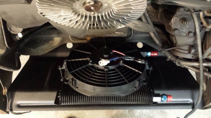

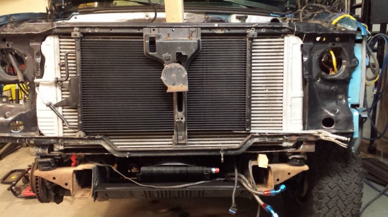

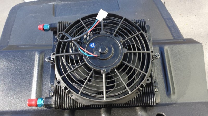

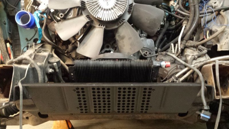

Here are a couple more pics of progress on grafting in the DMax IC/rad stack & relocating the B&M 48 plate oil cooler so it's not adding heatload to the A/C condenser or rest of cooling stack. The 3" body lift & 3500HD core support is what allows space to fit the oil cooler there. Will see if the oil cooler gets adequate airflow in this location. 004.jpg 012.jpg 016.jpg
We ran a trans cooler there on a gas truck. Got too hot for our liking without an electric fan. With the fan there were zero issues.
