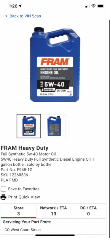

from what I have found online, Amalie makes the fram oil. bit not positive on this... can't be any worse that WM supertech oil !!
I do have a full 5 qt bottle of supertech 15-40 laying in the bed of the truck I had bought for top off oil a while back when we went on our vacation trip. but I have always been leery of using it. I could give the fram synthetic 5-40 a try since it's available here. it does seem promising more so that that article I linked about the supertech. the article does say it's not for performance. That makes me think ST oil just meets the bare minimum specs to get by on a budget.

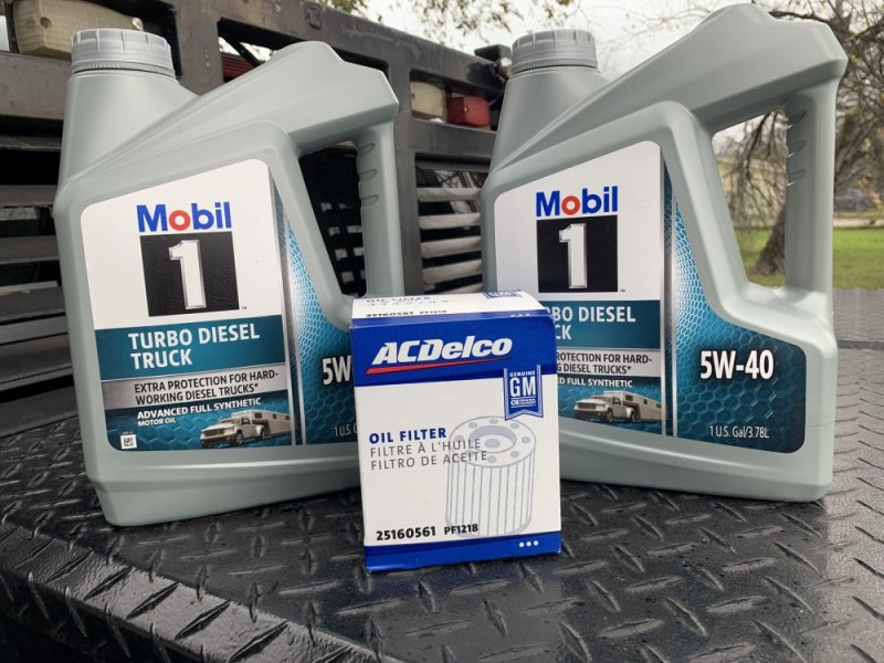

Just went oil shopping in town. Advance closed. O’riellys nothing on shelves. Stopped at the most dreaded store around, Autozone! Only thing they had was Mobile 1 5-40 So I sucked up on their prices at a little over $80 for two gallons and a filter and went for it. How much longer over 3k miles can I get on this stuff? I’m old school and not too intune with synthetics.
You should spend some time looking up oil filters. The ACDelco Ecore is a sad cheap filter anymore on par with a FRAM OCOD. They had to redesign ECores once due to filter failures taking out engines. They have the cheapest antidrainback valve known to harden and not work over time.
Best you can do is get a filter with a silicone anti-drain back valve.
Good luck trying to avoid FRAM, who via Champ labs makes ACDelco filters, and Purolator that now can hide in a Wix filter can because both are owned by Mann-Hummel ... Not many oil filters left untouched by these two cost cutting clowns.
Sadly it’s a fram I have on there’s now. I was in a hurry when I changed it before but in my defense it’s the better crappy one. I figured since going to this expensive stuff and since parts and oil is getting hard to come by other than ordering online I’d get the Delco one they had this time around
