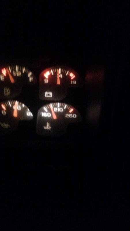

KIMG3622.JPGremember I put twin 170 thermostats in it.. I may not remember correctly but I thought somebody said the torque converter doesn't lock up until a certain temperature and this truck runs really cool since I switched the thermostat which was quite a while ago... I don't remember if it was about the same time as I did the brakes and tranny change
