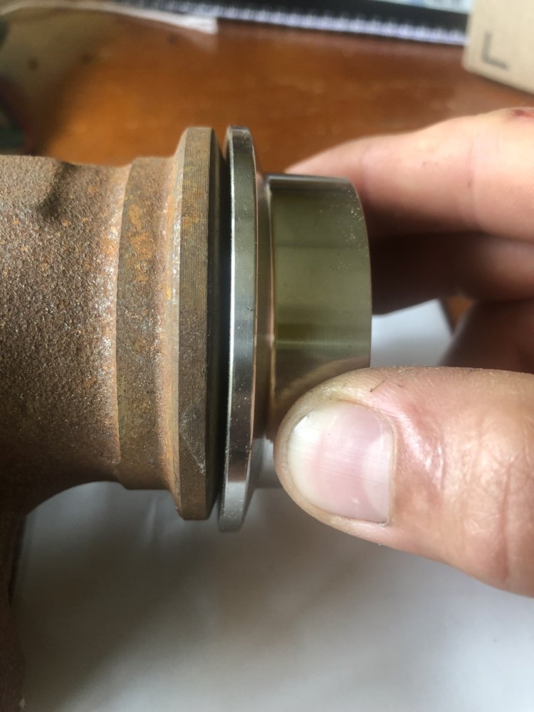

The first thing I addressed was the van/ hummer exhaust manifold. It has a tapered sealing surface to accept a flat face flare, like a turbo to a downpipe. So mating up to a vband flange out of the box is a no go
So what I did was take the manifold to a machine shop and have the flange milled down flat. I went this route because I wanted to be able to use a vband connection, and I wasn't sure stainless could take a flat face flare without cracking. Furthermore it proved difficult to find a shop around here that could do a flat flare, and given how I was going directly from the manifold to a short sweep elbow, flaring a curved piece of exhaust seemed more challenging than getting a face milled down.

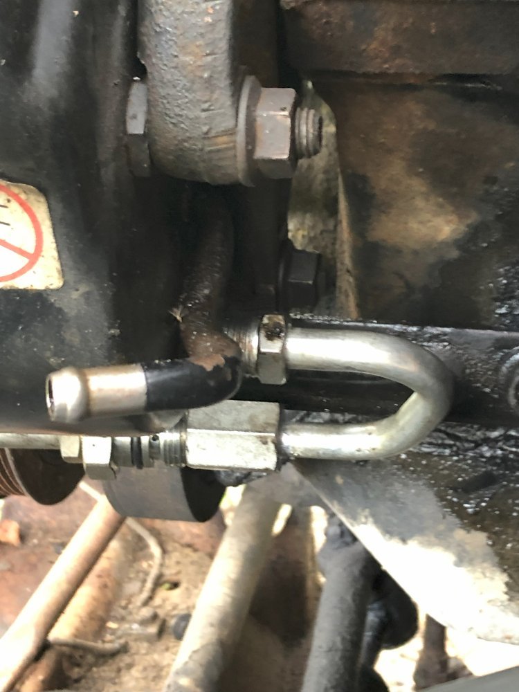

Next up was to figure out the power steering. On the 92/95 trucks, the pressure hose from the pump to hydroboost sticks out pretty far behind the pump and points directly at the van manifold
There are several workarounds to this. Others have used the driver's side manifold, which has an elbow on it already, albeit in the wrong orientation. In another thread on here this elbow was cut off and re- positioned to point down and clear the power steering line without issue. Another option is cutting off the flange of the manifold back to nearly the first bolt on the #1 cylinder and welding on a short sweep elbow.
Both of these options consisted of cutting and then welding cast iron, which I wanted to avoid. While doable, I did not want to change the continuous nature of the metal as I plan on getting the manifold ceramic coated and didn't want to go through that additional expense only to have a weld crack/ fail in the future.

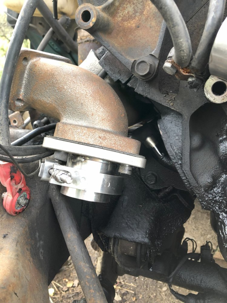

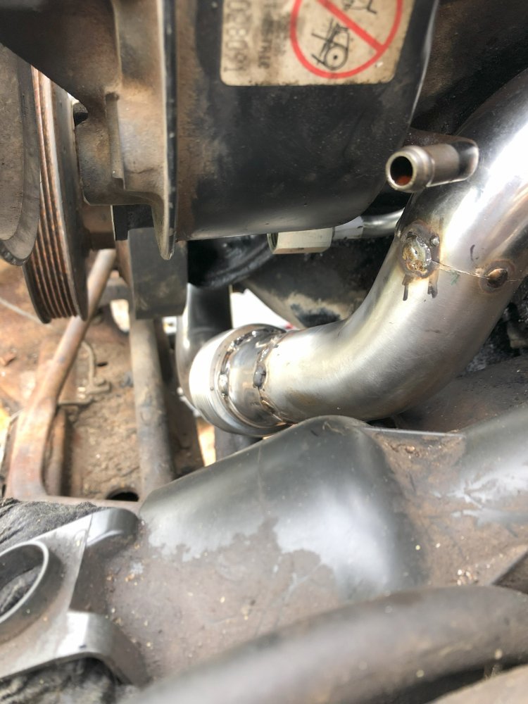

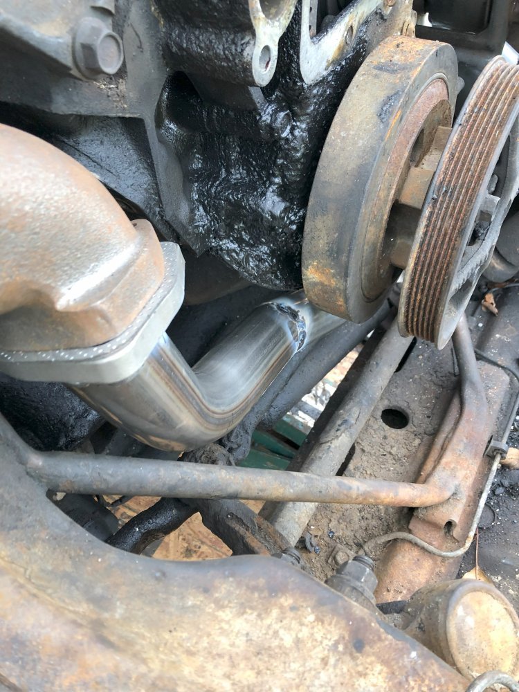

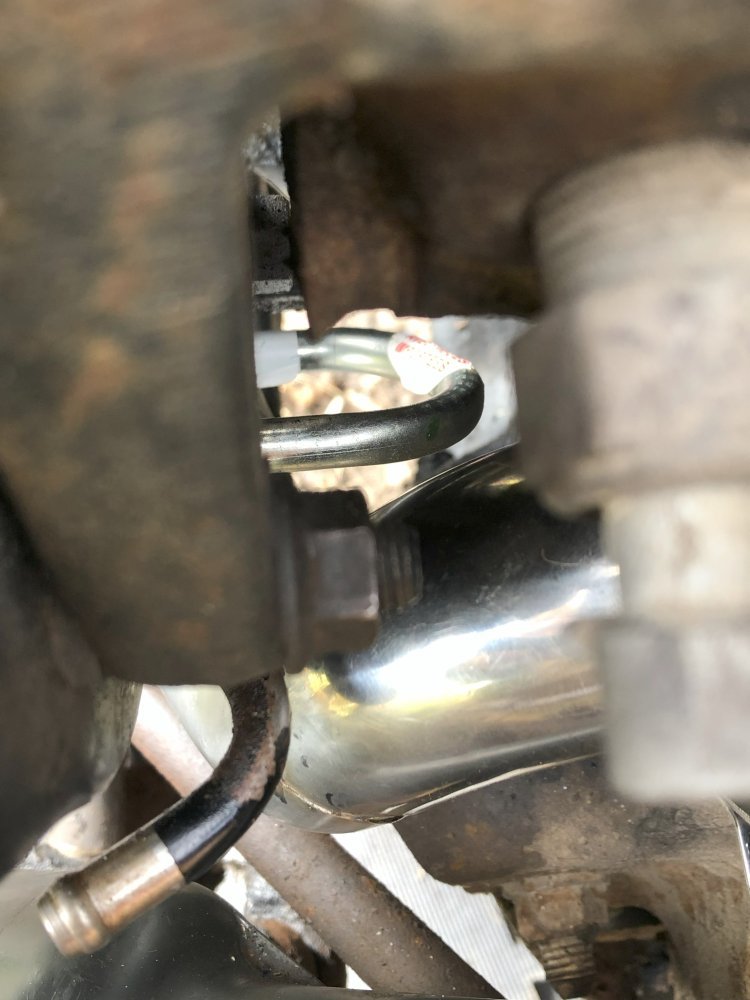

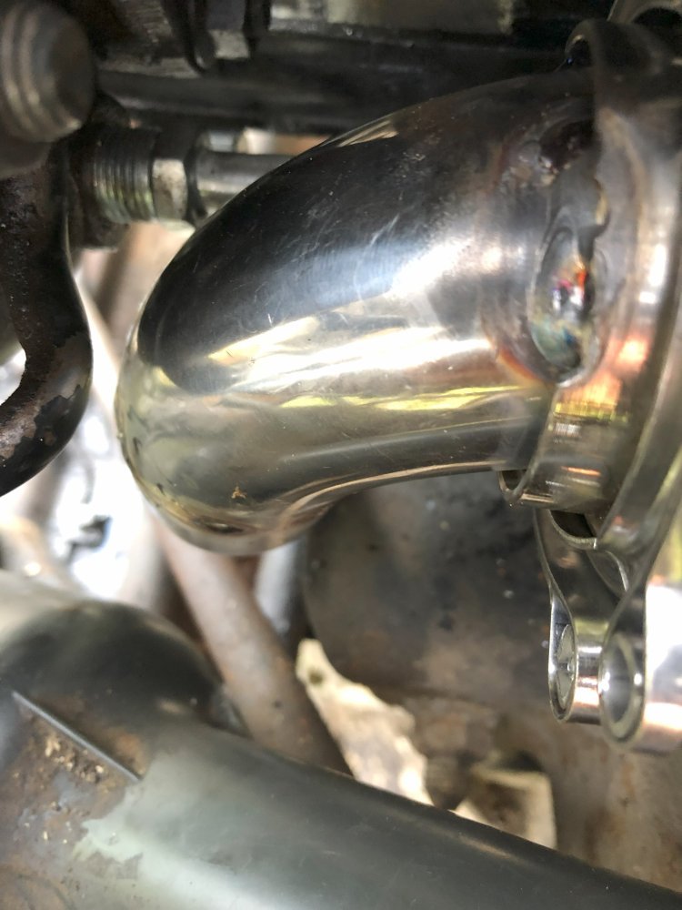

So what I did was use the GM EVO delete kit coupled with a later model power steering pressure hose. Credit goes to @dixiepc for bringing this little piece of hardware to my attention. It's an expensive little tube, but it allows for enough clearance to sneak a 1 3/4" elbow past the power steering pump without having to modify the manifold outside of machining it flat

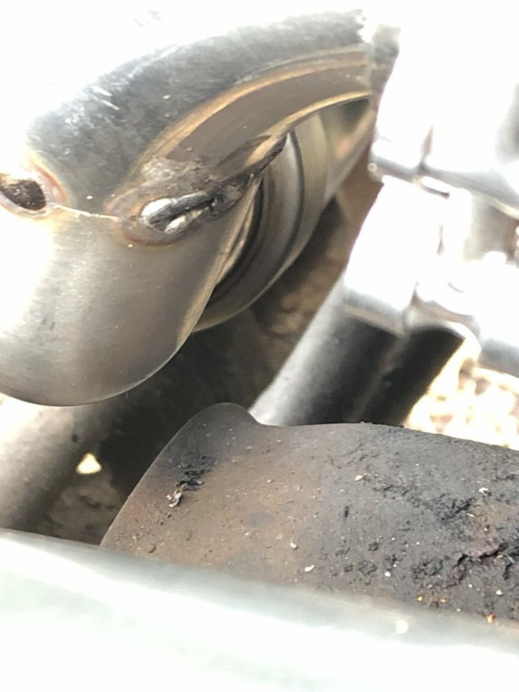

Additionally, even though the manifold is 1 3/4" in diameter on the inside, the flange accepts a 2" vband clamp. So without milling it smaller a 1 3/4" vband wont work. This proved helpful though, as to gain all the clearance I needed I slipped the 1 3/4" elbow into a 2" vband and made something akin to a cobrahead elbow. I'll have to weld the inside of the connection for the smoothest transition. I tried using a 2" short sweep elbow and it just didn't have the clearance.

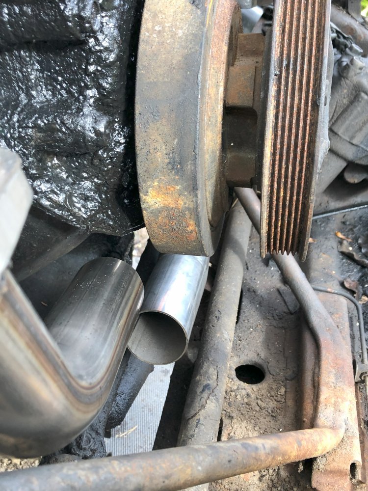

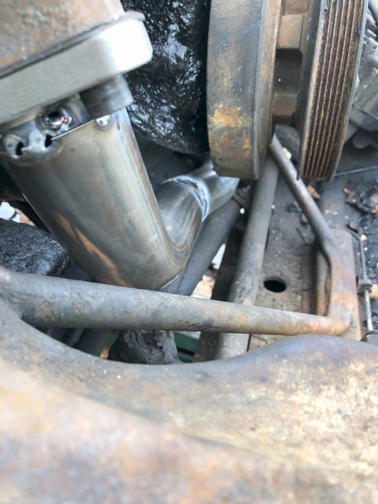

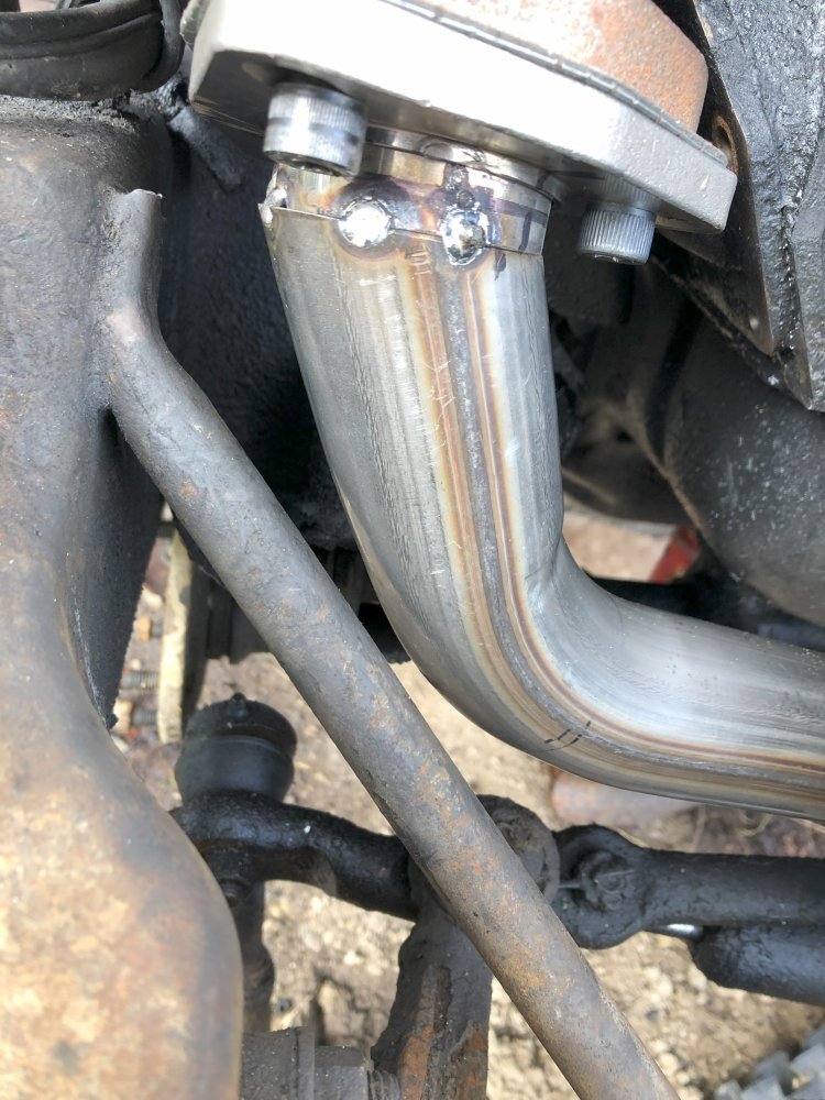

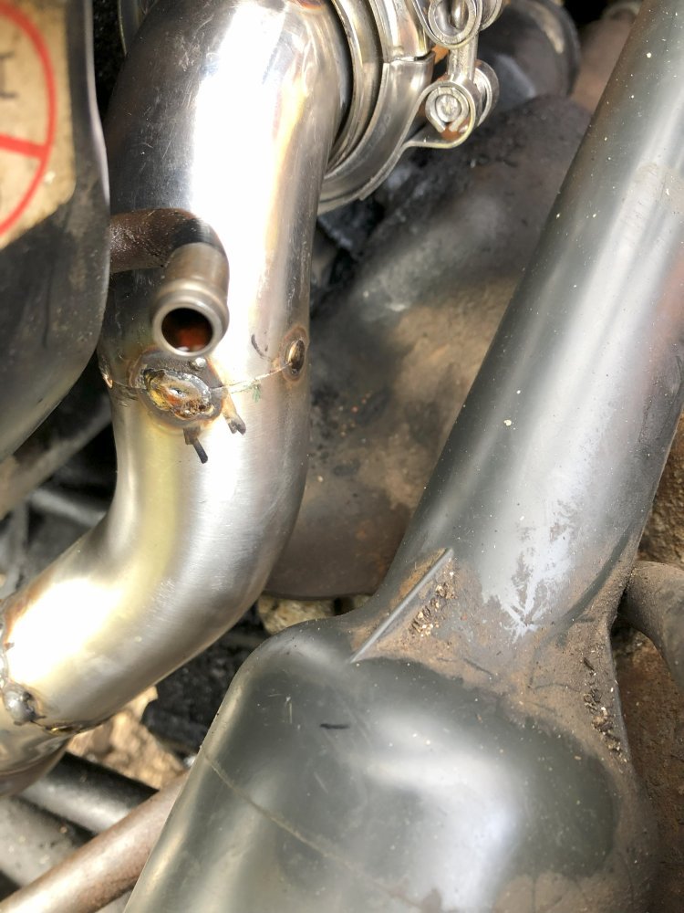

The goal of this upgrade is better exhaust flow, so stepping up to 2" as quickly as possible is the goal. On a whim I had purchased a 45* piece of 1-3/4" pipe, and I'm glad I did as it allowed for a smooth transition around the front diff mount and good orientation towards the passenger side destination

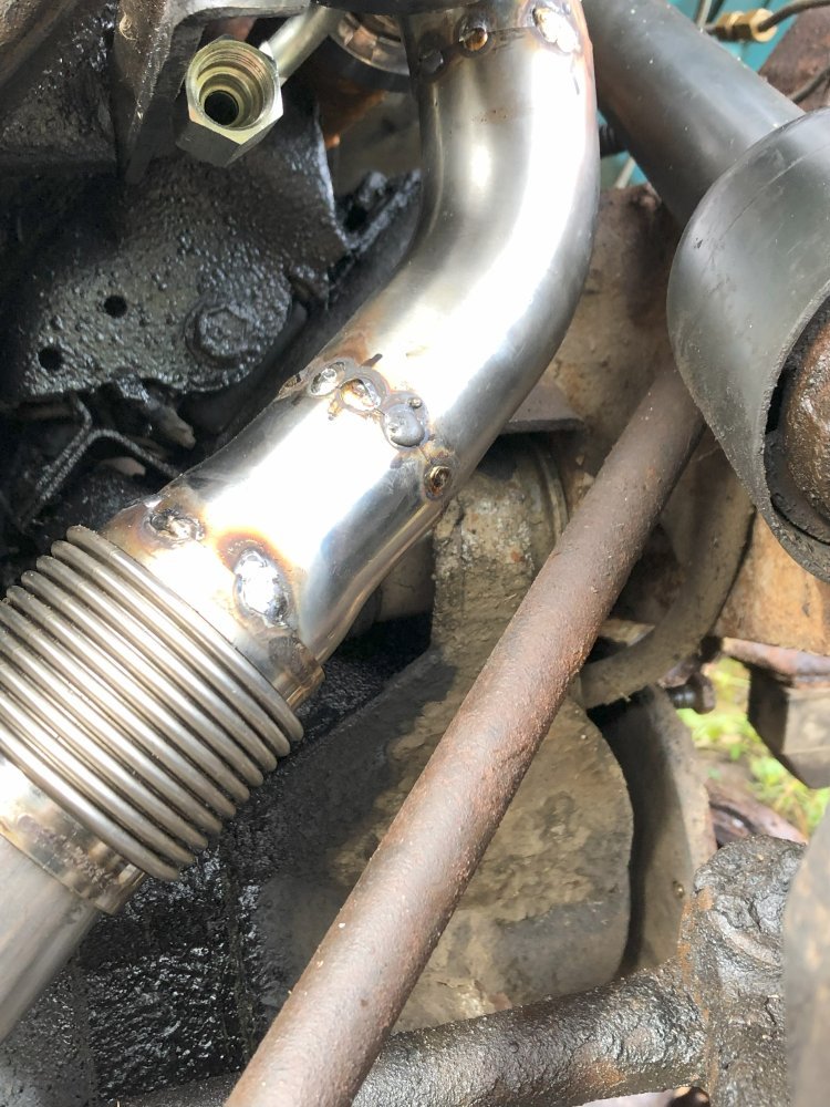

As seen in the above picture, I transitioned from 1-3/4" to 2" right after the 45* elbow. I purchased an extra thick adapter from CX Racing which was probably overkill but helped with the welding.

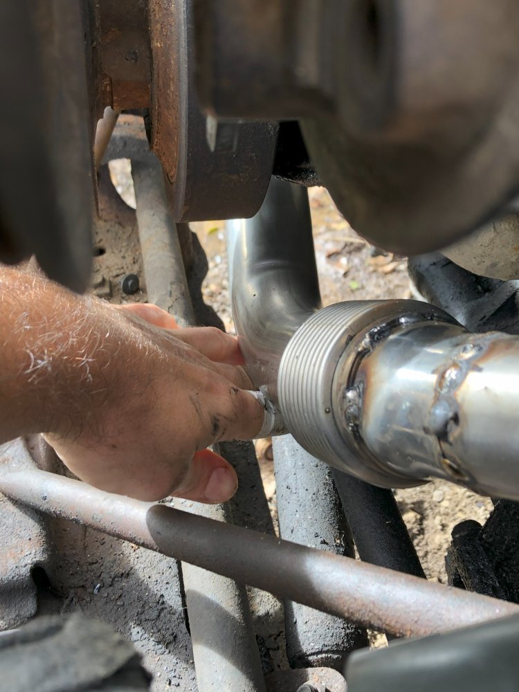

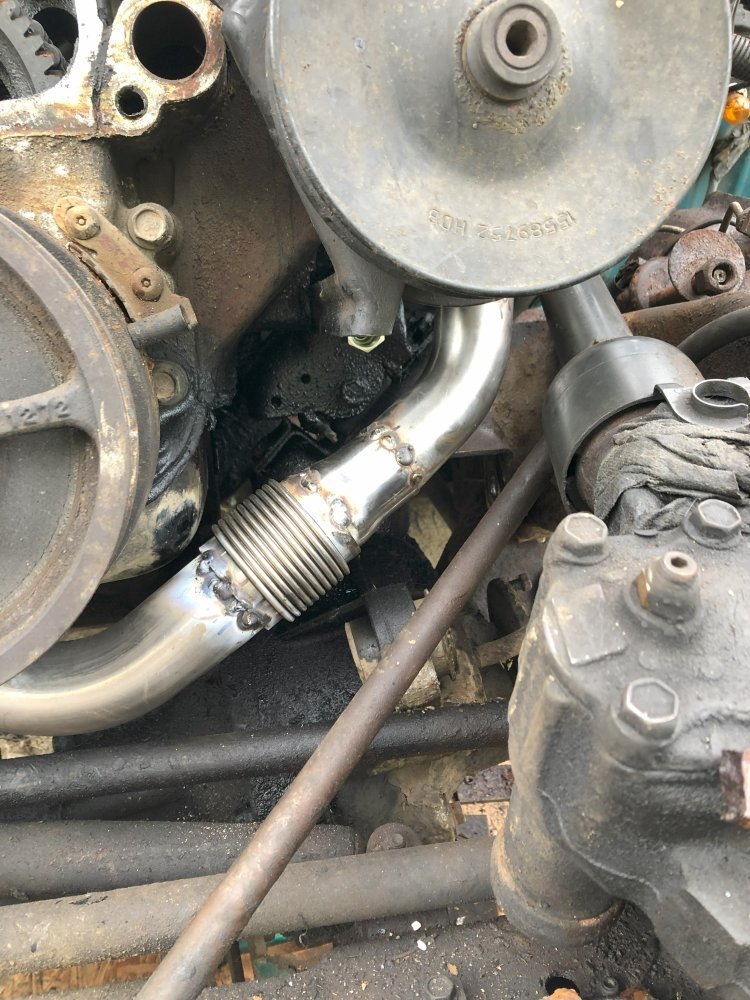

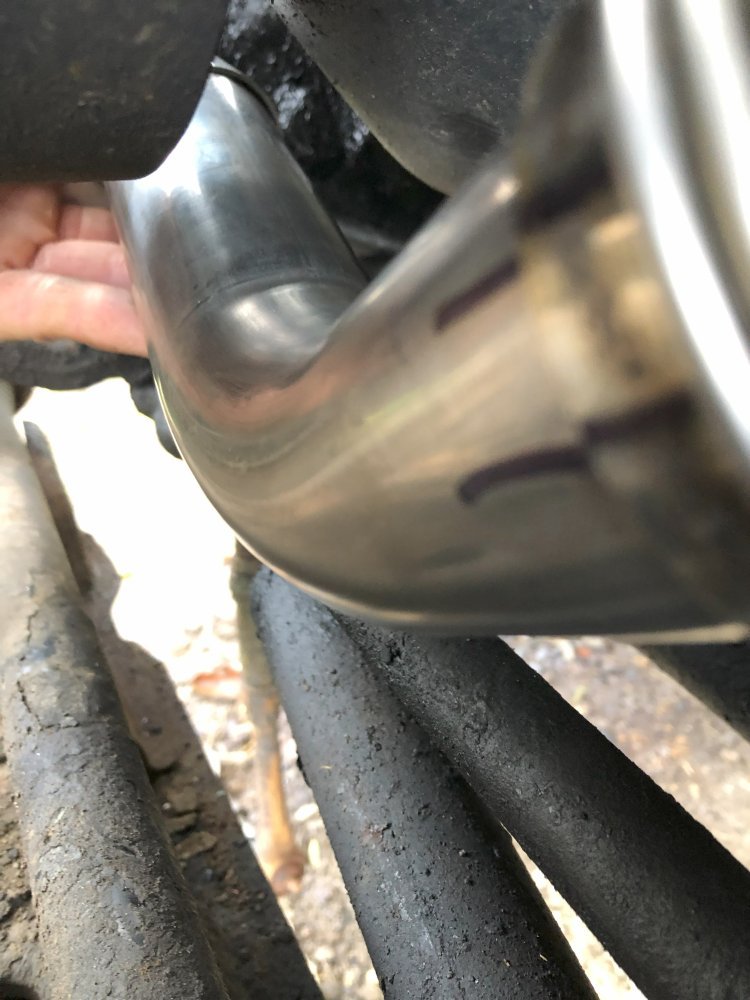

I also put in a bellows as soon as I got to 2". I think a bellows is necessary for this upgrade especially when using stainless. It also served as an easy coupler piece that gives some flexibility in positioning and orienting the next piece of pipe under the engine.

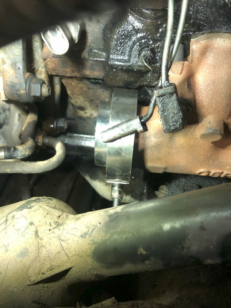

On the other side, I really wanted to use another Vband connection. The Banks manifold comes with a 2" 3 bolt flange cast into it, so I welded a 2" vband directly to a stainless 3 bolt flange. Getting away from the factory 3 bolt flanges was a goal here as well

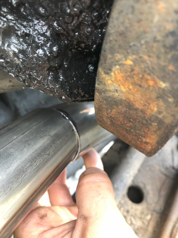

However, when trying to add in the next piece of pipe, it became clear that I couldn't go this route. The frame brace is in the way and every last bit of clearance is needed. So with a heavy heart, I had to remove the vband and settle for one side having a 3 bolt flange

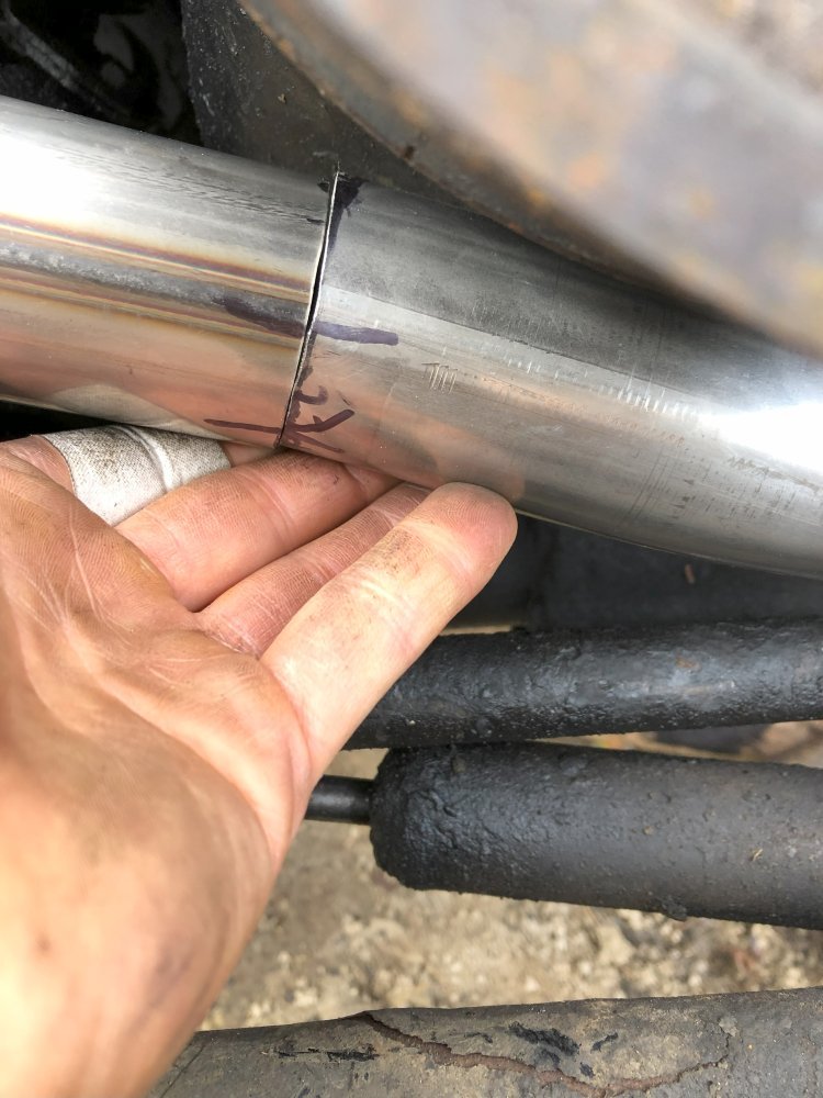

After that, it was simply a matter of getting the other 60* bend to mate up under the engine. This is where having the bellows on the other end greatly helped with the extra wiggle room

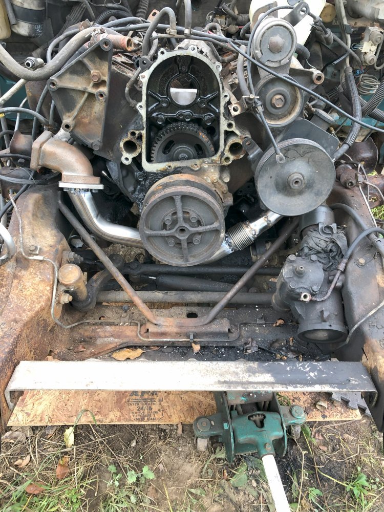

The crossover is all tacked up. I really recommend doing this with the engine in the truck. Doing so on a stand it would be really hard to account for all the frame clearances. The mock up engine is in a 1993 K3500 Cheyenne 1 ton dump with a blown engine. The new heart for the vehicle is currently in Chris' shop and will get its own thread when it's all ready to go. I was first thinking of doing this upgrade to my P400, but with the extra space taken up by the girdle I was unsure whether there would still be space for the crossover under the engine. So when the time comes the P400 will get my attempt at a centermount. But that's another can to kick down another road 🙃
Here's a few more pics of the complete piece in the truck. I took the tacked up manifold to a friend's shop earlier in the week to get tig welded together and...no argon, just 3 empty tanks :banghead: Hopefully it will get welded up in the next week or so.
