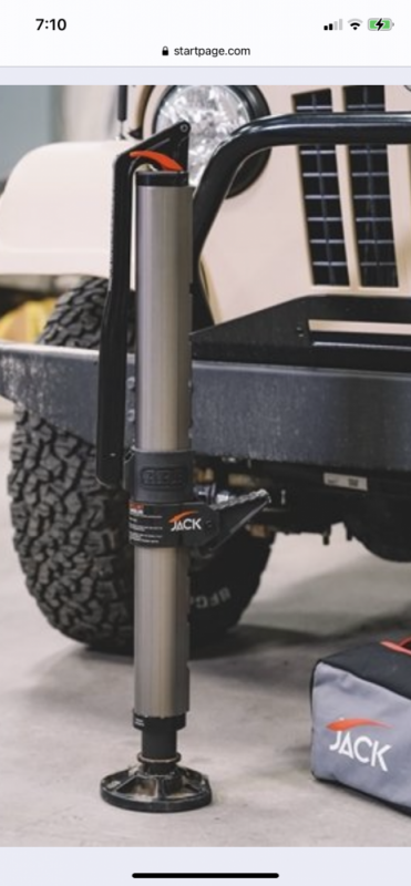

A couple pics for those who haven’t seen one yet. They are 3 foot tall. Weigh a few pounds less than the handiman/ hilift style jacks.

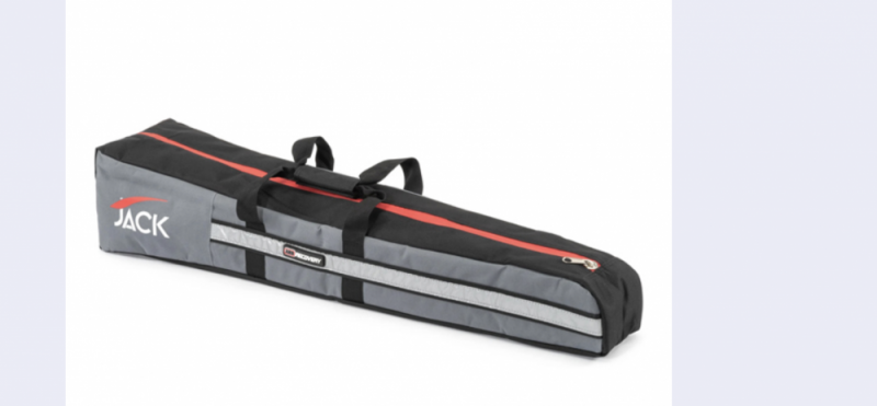

Note the bag- just the bag alone sure makes it seem they are ok to carry and store horizontally.
The price of $800 is painful but arb is not known for anything low cost so the price/ value is up to each person. I would like to see who ever does a better version of this in the future. Or if arb solves the current issue with a redesign of the leak problem because it sure felt safer to use and was definitely easier. There is YouTube videos comparing them but most are by people selling the arb so....
