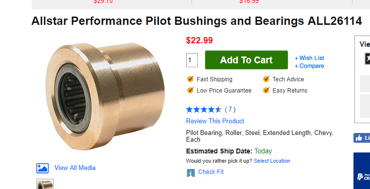

I hate going by just the picture but the pilot bearing looks like the oilite bronze type. Are you going to coat the snout of the input shaft for low friction?
Anyone have experience with this pilot bearing? When I used the GM pilot install tool it left my pilot sticking out of the crank bore by appearances similar to the larger od on this bearing?????

I prefer the bronze over rollers, when the rollers give out it takes the shaft with it...
I dont have experience with that particuliar bearing, but Jeep used one like it back in the 80's with the tiny inner bearing and a sleeve, and they were nothing but trouble. They switched over to one with larger needle's in it like GM's oem.
