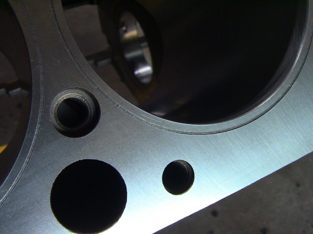

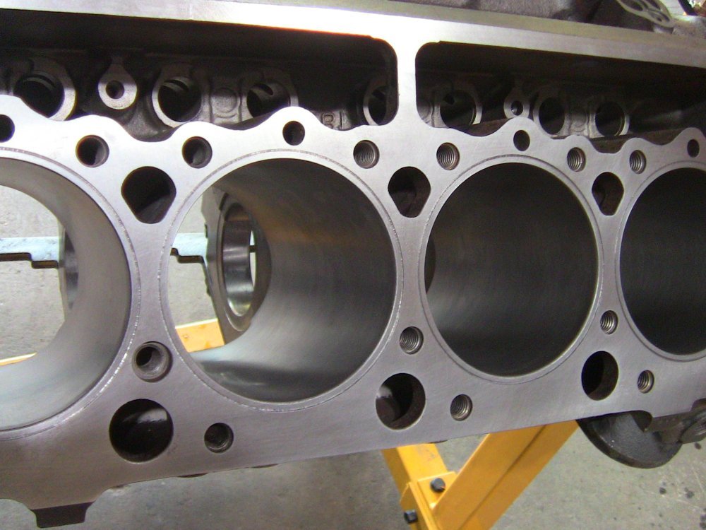

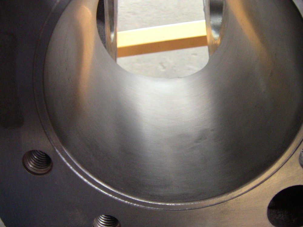

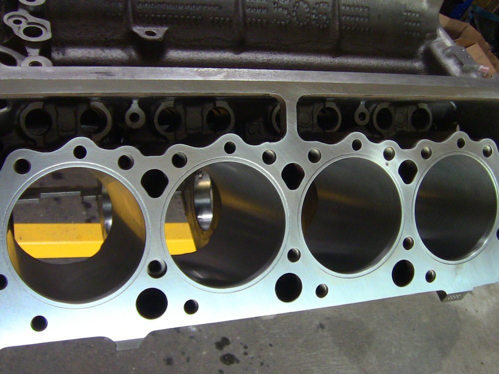

Next 506 build ready for assembly.
This customer wants a all out maximum strength and power build.
Short list of mods.......
Block has been line bored & honed, splayed main caps, Halo Girdle, fresh cylinder hone, fire ringed deck, block decked, short filled block, total seal ring set, 18:1, race spec rotating assembly balancing, head porting, and a full array of our coatings, and a custom cam grind to name a few.
