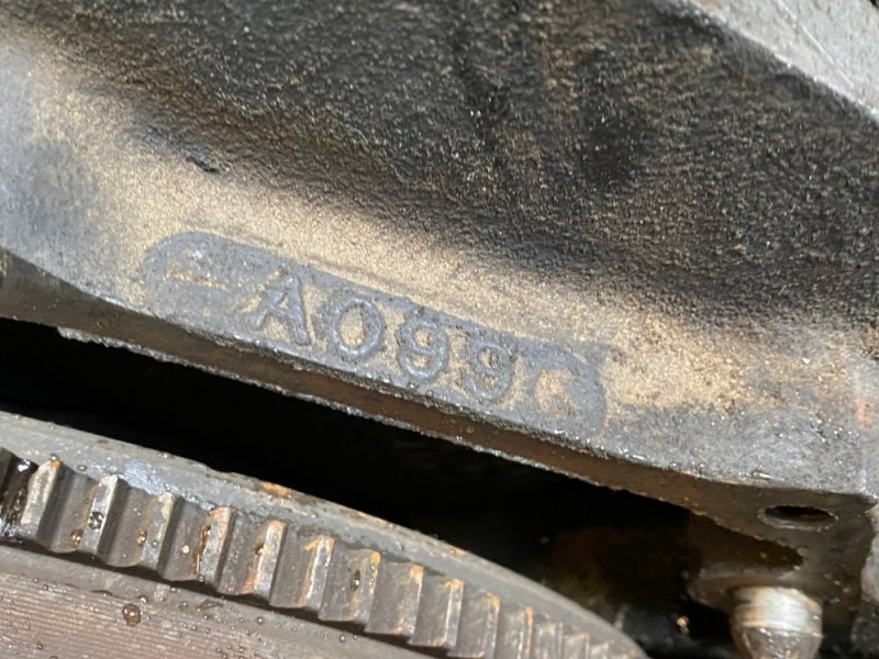

This weekend I picked up an early 99 6.5. It has some interesting features, so I thought I'd share what I found. I have read that 506 blocks beginning with date code C159 (March 15, 1999) are the first blocks with the final updates GM made to the blocks. This block that I just got has an A099 date code (January 9, 1999), so it shouldn't be an updated block.

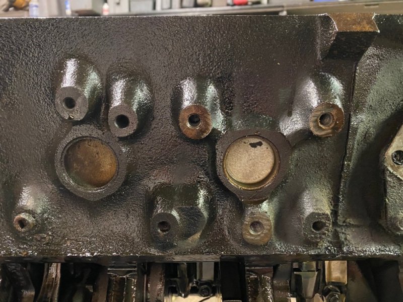

What's interesting though is it seems to have SOME of the updates, I'm just not sure how many. It has the updated motor mount bosses on the side like the post-C159 blocks.

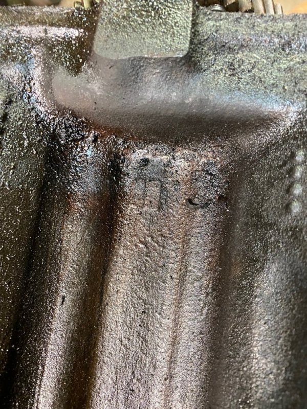

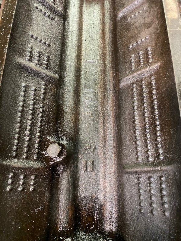

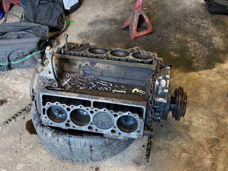

It also has the double bars in the valley like the post-C159 blocks. However, it does NOT have the "506" cast into the valley like the later blocks.

What did this come out of? MT and a weird V Belt setup looks like.
It was in an 86 squarebody at the junkyard near me. They must have had to replace the original 6.2 at some point. It had a retrofitted AC system on it as well. Now stop snooping at my pics so closely!! 🧐😝
