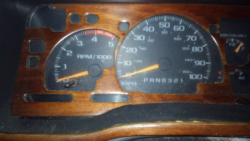

I don't know what the STS light is... The service engine soon light kicks on when the event is happening but kicks right back off when you let off the accelerator then get back on it... Actually I don't think it's the regular service engine soon light.. it's another one right above the one that comes on when you turn your ignition on.. my gauge cluster has a designer thing on it so until tonight I've never even seen that light before , I just happened to be in the right position to see past it I'll post a pic so you understand what I mean...you have your wait to start light then right above it you have a check engine light... The light I'm referring to is right above that one. but like I said I only saw it because of the position I was in at the time it kicked on
STS ..service throttle soon.. I just ripped some of that designer crap off my dash and light came on when I turn the ignition on... Here's the weird thing or maybe it's not weird I don't know I put the fuses back in and the problem went away... Which is kind of disappointing because I want to eliminate the ABS
