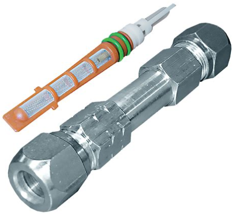

3. probably the most damming situation for me... when I last had toe front grille off the truck, I realized that someone before me had installed one of those orifice tube repair kits on the condenser. will these vov valves fit inside of one of these "holders" since I think they are slightly longer than a fixed orifice tube. (current one installed is black in color)

I'm still interested in the vov orifice, if it will help. I may even need to go a step further an replace the condenser since a PO modified it and installed that orifice "repair" kit on it.
one of these gizmos is attached to the condenser!
ya know, this might sound dumb, but now I'm sitting here thinking about it.... someone installed that repair kit on the condenser that holds the orifice tube... did they install it backwards? did I install the new orifice backwards? lol I can't remember. I just remember putting the new OT back in the same way the old one came out! I wonder if a backwards orifice tube would cause weird pressure readings and explain why something isn't right and acting the way it is. acting like it's low but actually overcharged!

The repair kit is in there because the condenser threads are aluminum and ALWAYS seize to the steel fitting on the line. The switch on the condenser is there to put the AC on inside air mode when the high side pressure reaches 325, and it reopens around 225-250. This is the switch that GM used to activate the auxiliary electric fan on 454's. There is a high pressure cutout switch mounted in the compressor, and the low pressure cycling switch at the accumulator. All the threaded fittings in the r134 AC system are metric, so good luck finding a trinary switch for it. There is a high pressure switch that GM uses for activating electric fans, but it goes into the circle port in the compressor where your current high pressure cutout switch is at.

as for the repair kit the PO installed. should I look at a replacement condenser or just verify they installed it in the right orientation?

I don't like those repair kits and the stock 95 condenser was a serpentine capillary ribbon design that was crap for r134 to begin with. I would install a high pressure cutout switch at the condenser and install the purple compressor mounted switch to trigger your evc. 325 psi on and 225 off is a bit on the high side to run your high side pressures. The purple switch closes at 283 and opens at 210. There is also one that closes at 240 but it doesn't open until 150.
